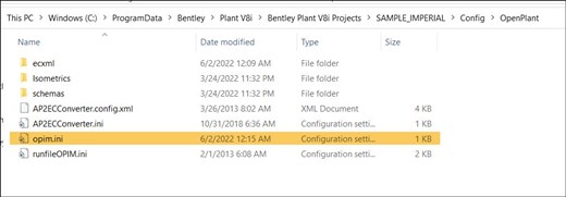

1.Navigate to the OpenPlant folder of the specified Project where Spec need to be added in the given Isostyle.
C:\ProgramData\Bentley\Plant V8i\Bentley Plant V8i Projects\SAMPLE_IMPERIAL\Config\OpenPlant

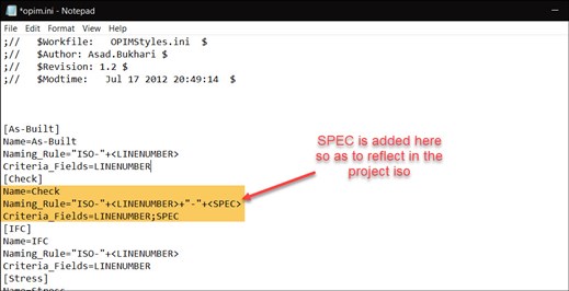

2.Open OPIM.ini file and add Spec Criteria manually as shown below.

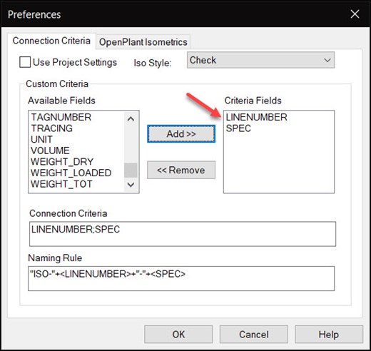

3.Once the above changes are made generate the Isometrics and verify that Spec Criteria is coming in Isometrics dropdown Window.
