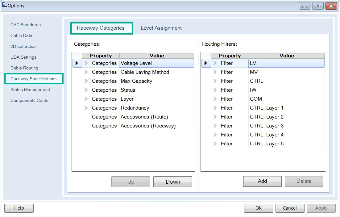

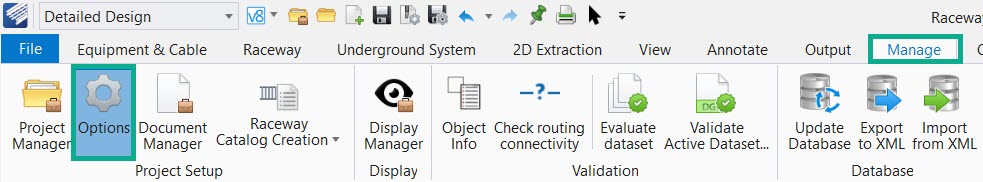

  1. Select the Options tool in Manage tab and Project Setup section.
  2. Select the Raceway Specifications and then select the tab Raceway Categories. Note: In the Categories window, the available Raceway Categories are listed. To customize the Raceway Properties dialog, the categories can be rearranged by selecting one and using the Up or Down function. The top three categories can not be changed.

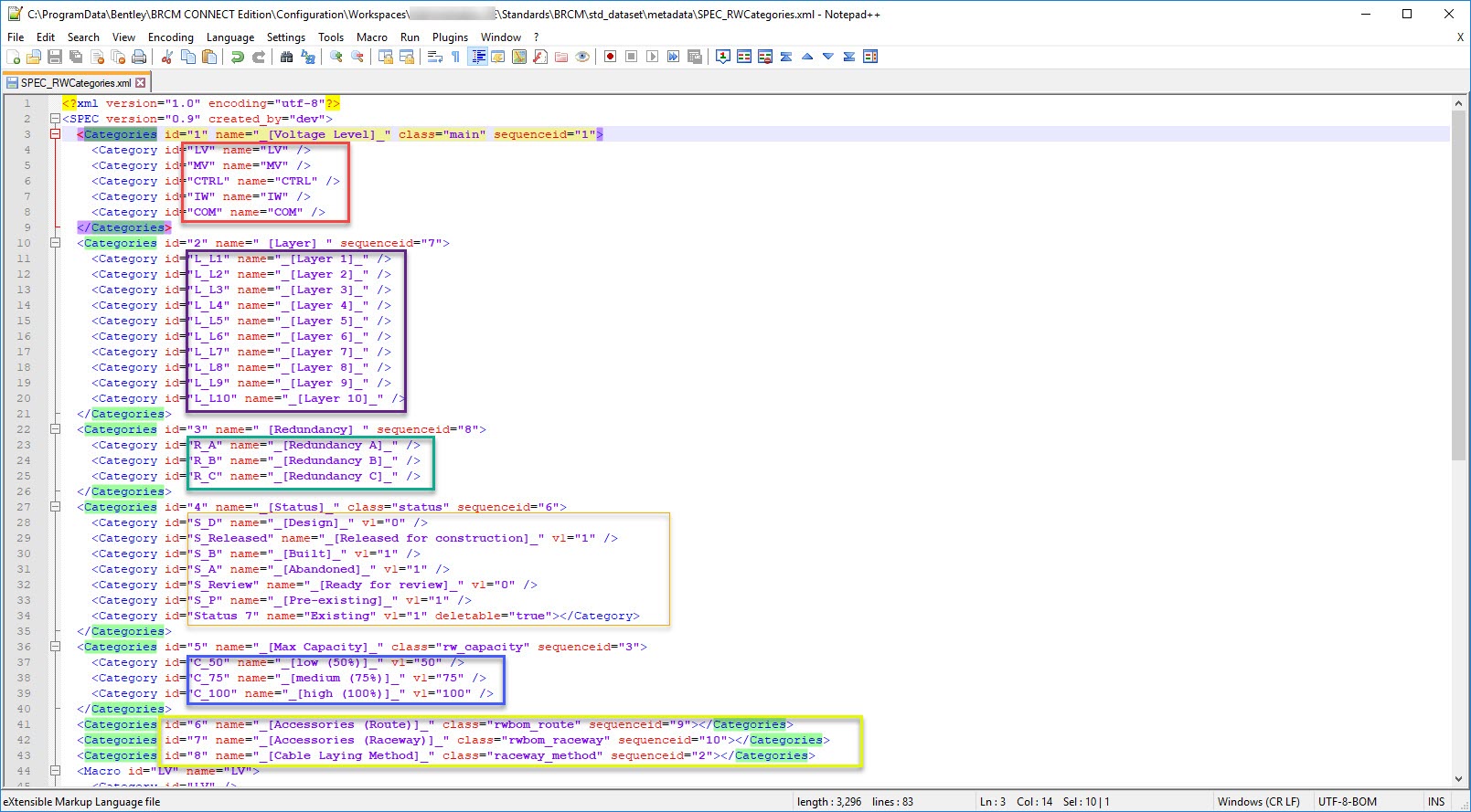

  3. A manual change of the categories is possible in file SPEC_RWCategories.xml located in metadata folder e.g.
    C:\ProgramData\Bentley\BRCM CONNECT Edition\Configuration\WorkSpaces\BRCM Metric Example\Standards\BRCM\std_dataset\metadata
  4. Open that file using e.g. Editor:
    Note: It will show the different Categories with it´s entries.

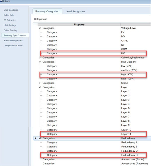

  5. Edit the SPEC_RWCategories.xml file using e.g. Editor and add following entries by copying an existing entry (Voltage Level):
  6. Make the required changes to other entries.
    Save the SPEC_RWCategories.xml file and reopen the Options, Raceway Specification, Raceway Categories tab. It will show the new
    entries:

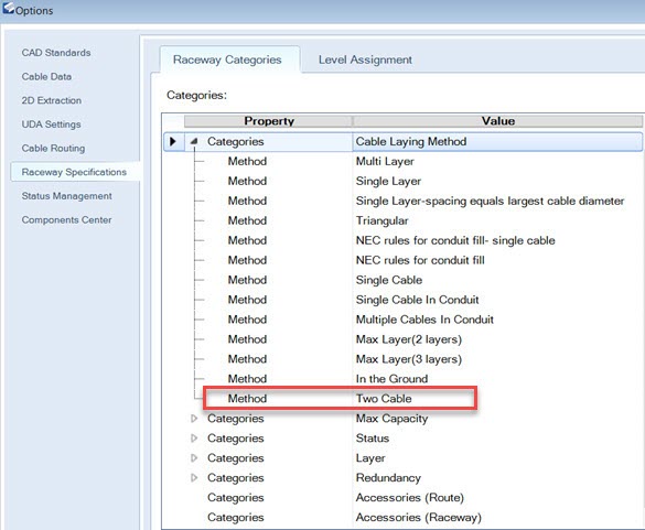

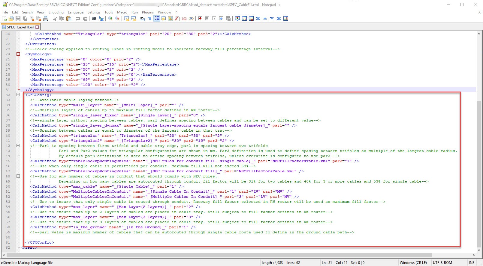

  7. To change the Cable Laying Methods open file SPEC_CableFill.xml in metadata folder e.g. C:\ProgramData\Bentley\BRCM CONNECT Edition\Configuration\WorkSpaces\BRCM Metric Example\Standards\BRCM\std_dataset\metadata.
  8. Add an additional Laying Method name _Two Cable_” by copy an existing and change the par1 to 2 (max. number of cable):
  9. Save the SPEC_CableFill.xml file and reopen the Options, Raceway Specification, Raceway Categories tab. It will show the new entries:
