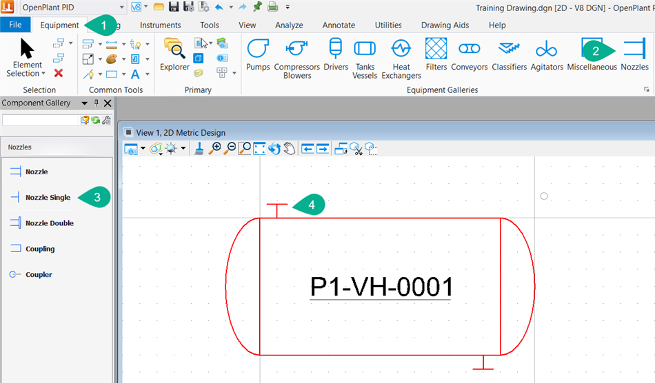

  2. Place a Vessel and add a couple of nozzles on it.

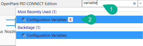

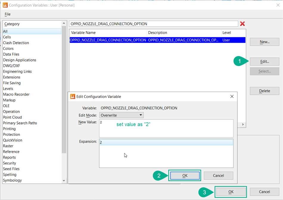

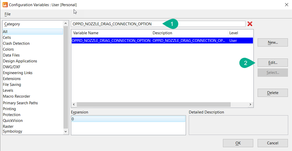

  3. Search for the Configuration Variables dialog in the search ribbon field.
  4. In the Configuration Variables dialog, search for the OPPID_NOZZLE_DRAG_CONNECTION_OPTION variable.

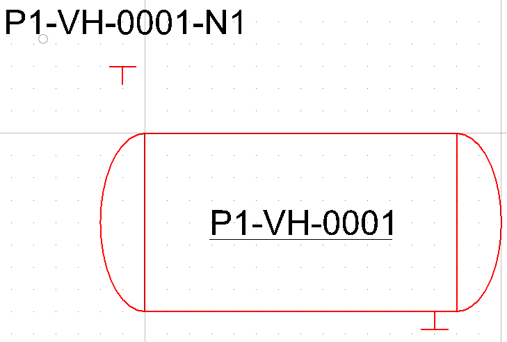

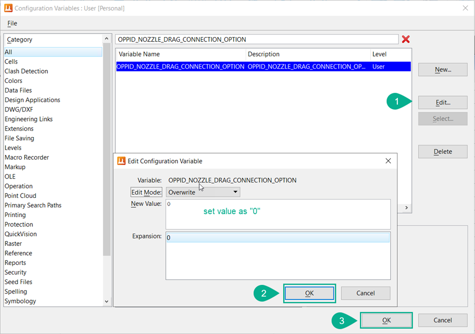

    When OPPID_NOZZLE_DRAG_CONNECTION_OPTION = 0 (Connection is not broken if nozzle is moved off equipment)

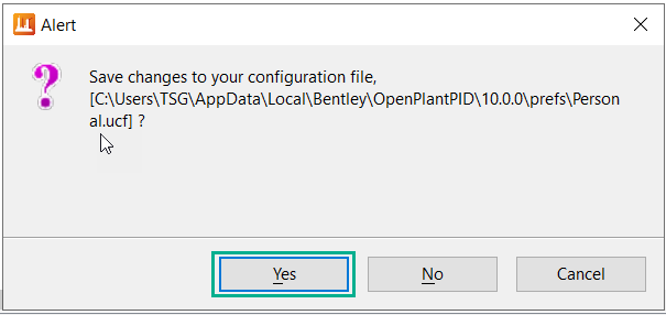

  1. Set value of OPPID_NOZZLE_DRAG_CONNECTION_OPTION = 0. Click ok and save all changes.

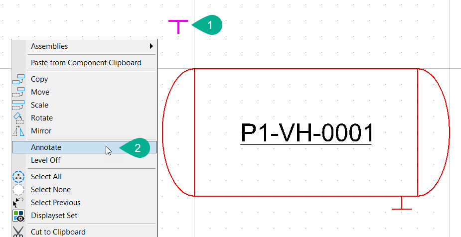

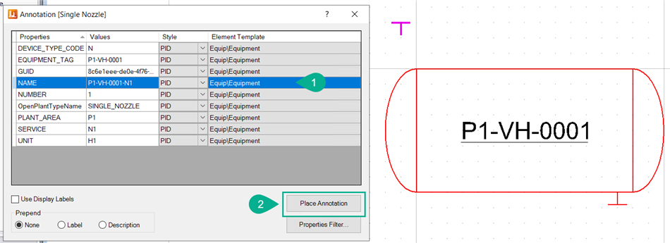

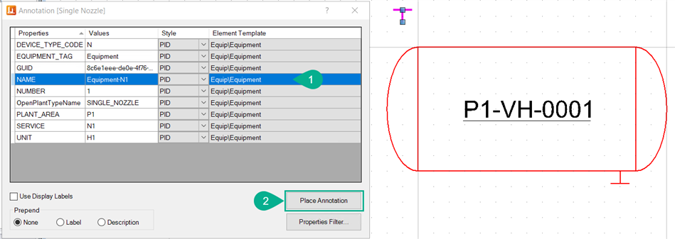

  2. Verify the result by dragging the nozzle off the equipment. Place Annotation for the nozzle by right clicking on it and selecting, “Annotate”. Place the “NAME” property to see that the Nozzle maintained the  connection with the equipment.

  1. Set value of OPPID_NOZZLE_DRAG_CONNECTION_OPTION = 1. Click ok and save all changes.
  2. Verify the result by dragging the nozzle off the equipment. Place Annotation for the nozzle by right clicking on it and selecting, “Annotate”. Place the “NAME” property to see that the relationship between the nozzle and equipment has been broken.

    When OPPID_NOZZLE_DRAG_CONNECTION_OPTION = 2 (A Prompt for keeping the connection or breaking the connection)
  1. Set value of OPPID_NOZZLE_DRAG_CONNECTION_OPTION = 2. Click ok and save all changes.

  3. Place Annotation for the nozzle and Verify the result as mentioned in Case I and Case II.
