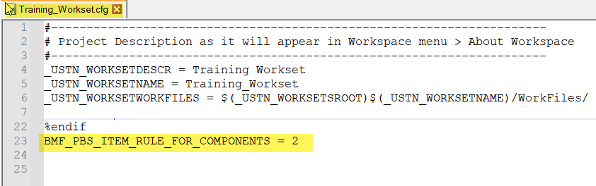

  1. Navigate to workset level and Open workset.cfg file in Notepad or Notepad ++.
  2. Add BMF_PBS_ITEM_RULE_FOR_COMPONENTS = 2 at the end of cfg file and save the workset.cfg file.

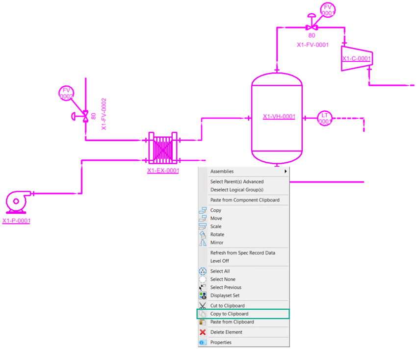

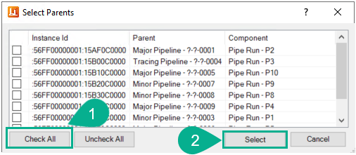

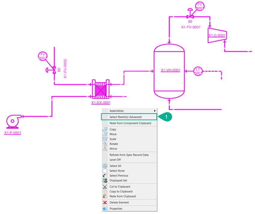

  4. Select components or assembly. Click on Select Parent(s) Advanced and follow the sequence as shown below.
  5. Right-click on the drawing interface and select Copy to Clipboard.

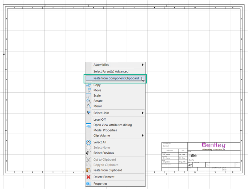

  6. Navigate to a new drawing and right-click on the drawing interface. Select Paste from Component Clipboard.
    Note :-

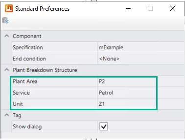

    There should be some values in standard preferences for PBS items to the new drawing.

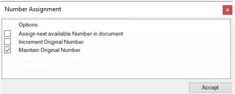

  7. Number Assignment dialog will appear. Select the desired option from Options. In this case, Maintain Original Number is selected.
  8. From next dialog prompt, select desired option as per the requirement. In this case “Use Active Plant Breakdown Structure Item Values

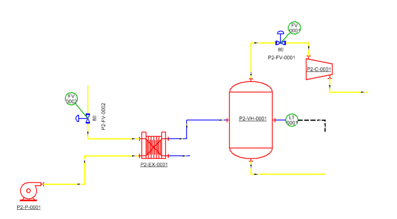

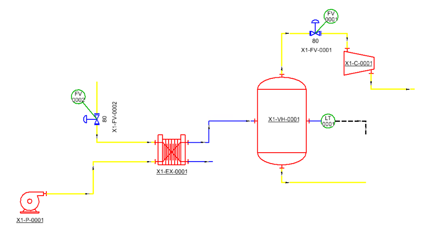

  9. Notice that for the pasted arrangement, number value has maintained as original assembly. However, for the PBS items, it picks the value from the active Standard Preferences.
  10. If in case, selected the option “Use Plant Breakdown Structure item values from original components” from Choose Plant Breakdown Structure items source components dialog box then it will retain the same PBS values from assembly.
