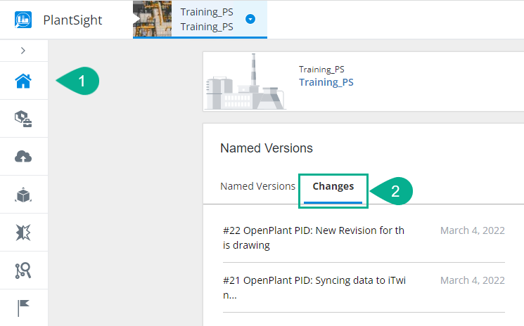

  7. Navigate to PlantSight to review the committed change.
  8. Click on Home icon and from the Named Version, select Changes.

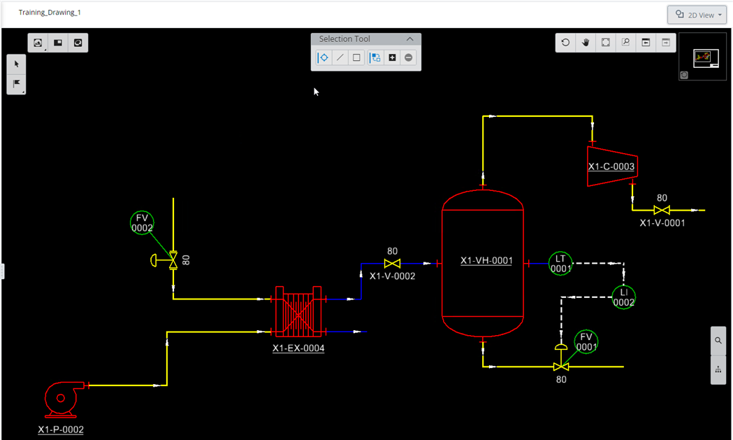

  9. Click on Comment to verify the result. Make sure to select view as 2D View.
