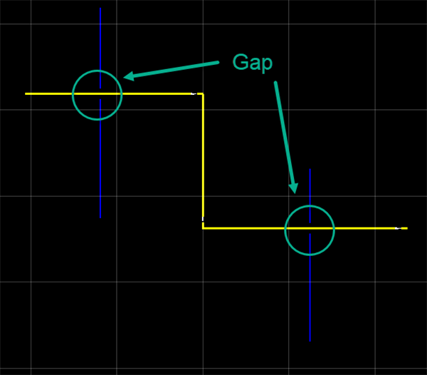

In OPPID CE U10 Normal Pipelines (Major, Minor,....) does not break up, when they are crossing each other.
This wiki article helps to achieve the result of breaking the Pipeline crossing each other.

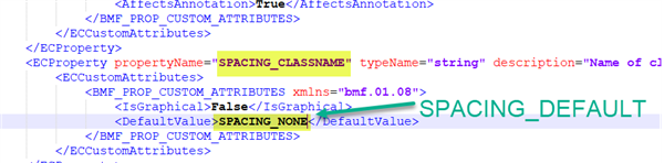

  1. From File Explorer go to your particular WorkSpace and Workset. In this case WorkSpace OpenPlant Example and Workset Imperial.
  2.  Open OpenPlant_PID.01.08.ecschema.xml schema in Notepad or NotePad++
    Path:C:\ProgramData\Bentley\OpenPlant CONNECT Edition\Configuration\WorkSpaces\OpenPlantExample\WorkSets\Imperial\Standards\OpenPlant\Schemas
  3. Find SPACING_CLASSNAME class and change the Default value of the SPACING_CLASSNAME property to SPACING_DEFAULT from SPACING_NONE as shown below.

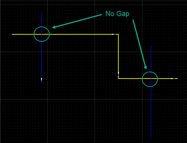

  4. Save and Verify the result.
