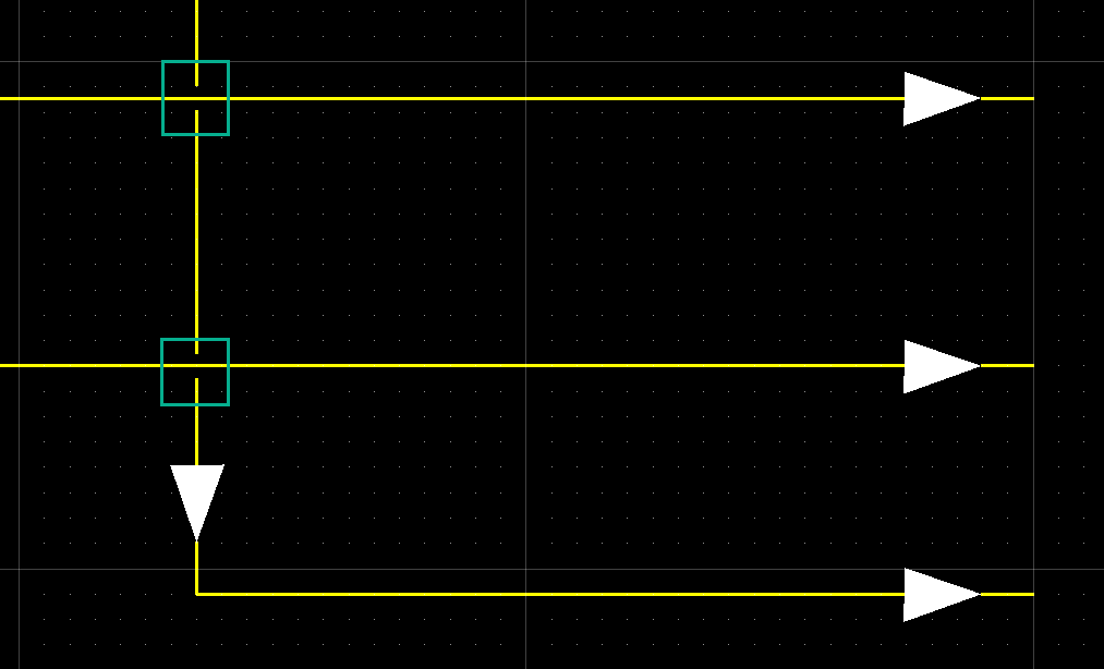

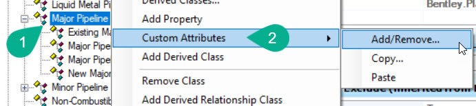

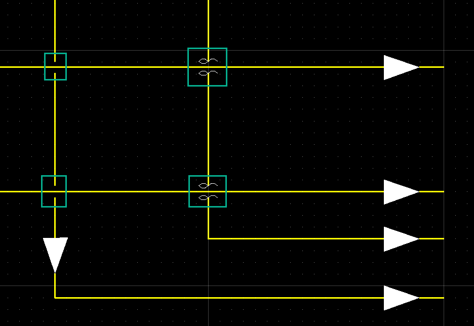

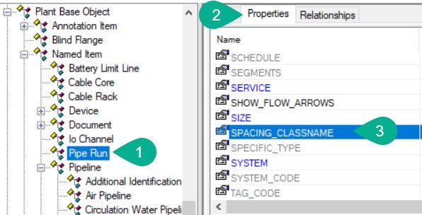

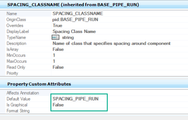

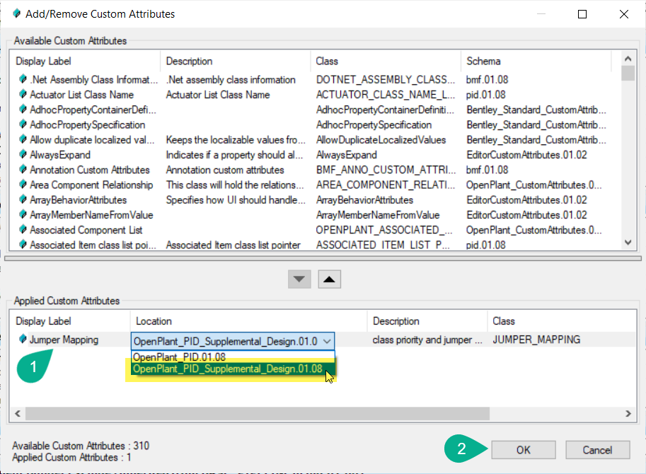

In OpenPlant PID, By default when two lines cross a gap is created. In this process you will modify the schema so that the jumper as shown in rectangular box used when two lines cross is an Squiggly line Jumper instead of the default jumper
