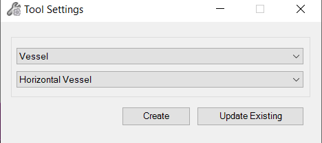

  5. Create Microstation graphics and select the graphics using element selection. Click on create equipment as shown below
  6. Select the equipment type from tool settings and click on create.

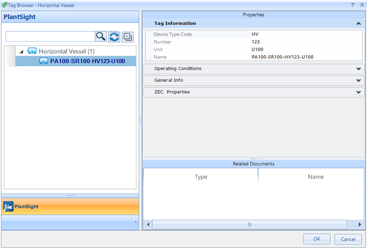

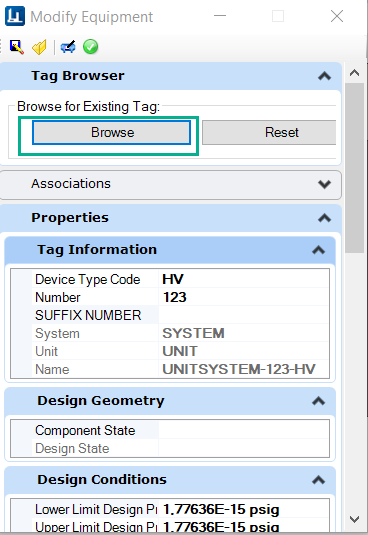

  7. Click browser and select the plantSight tag as shown below
  8. Select the PlantSIght tag and click on ok

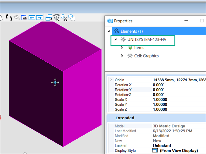

  9. Check the properties of the equipment, the PlantSight tag was added for the equipment.

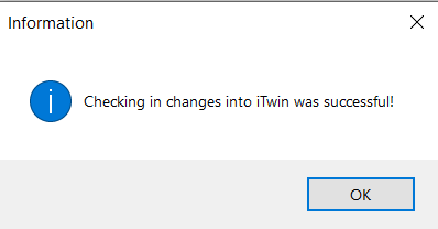

  10. Check in the data into plantSight.
