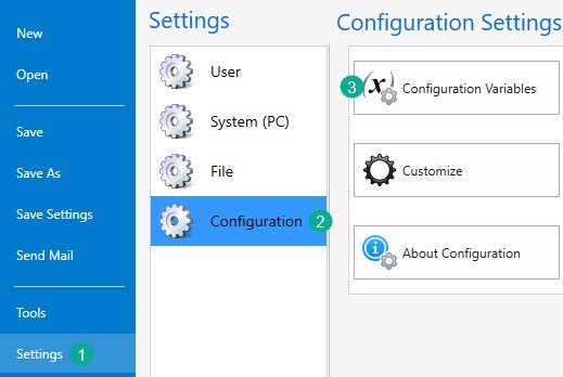

  3. From Backstage window, select Settings > Configuration > Configuration Variables as shown below.

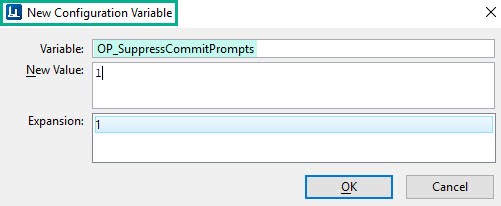

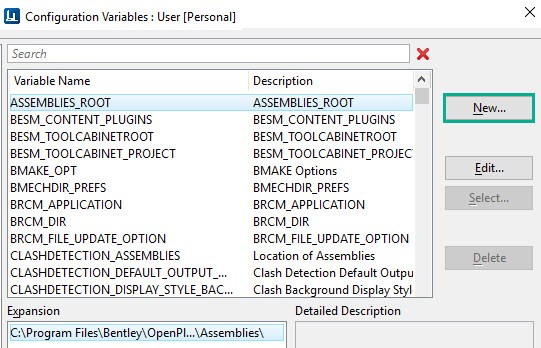

  4. From Configuration Variables dialog, click on New to define a new variable. Refer image below.
  5. Under New Configuration Variable Dialog, enter Variable name as “OP_SuppressCommitPrompts” & New Value as Refer image as shown below.
  6. Once done click on
  7. Click on OK From Alert prompt, select Yes to save the changes, refer image below.

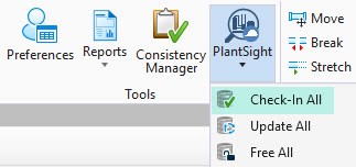

  9. For desired model file, select PlantSight > Check-in All operation as shown below.
  10. Notice that once variable has been evoked, no PlantSight Differences dialog can be seen & all OpenPlant 3D model data checked-in to PlantSight portal. In message bar we can see the status of our check-in operation.
