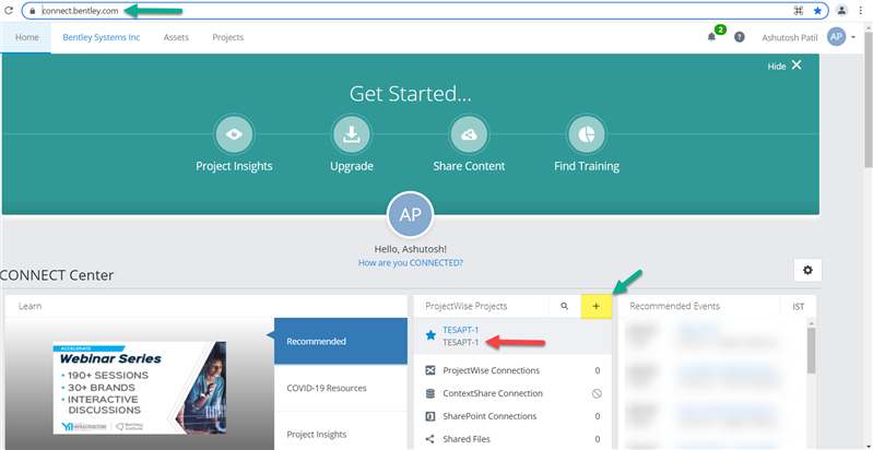

  2. You can register new project as well from below link
    https://connect.bentley.com/
    Register New Project overhere e.g TESAPT-1

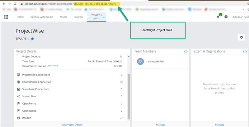

  3. Click on new created project TESAP-1 and get inside it.
    And verify the Guid in address bar of browser mainly chrome as shown below

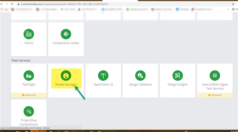

  4. Get inside the project and scroll down and click on iModel icon.

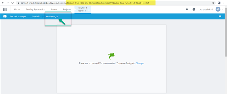

  5. As you enter iModel Window view the address bar which would have guids combined of registered project (Guid)-iModel-iModel(Guid)

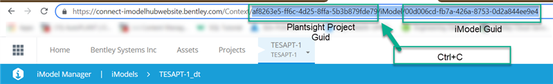

  6. Copy the Guids content from addressbar,“ af8263e5-ff6c-4d25-8ffa-5b3b879fde79/iModel/00d006cd-fb7a-426a-8753-0d2a844ee9e4 “

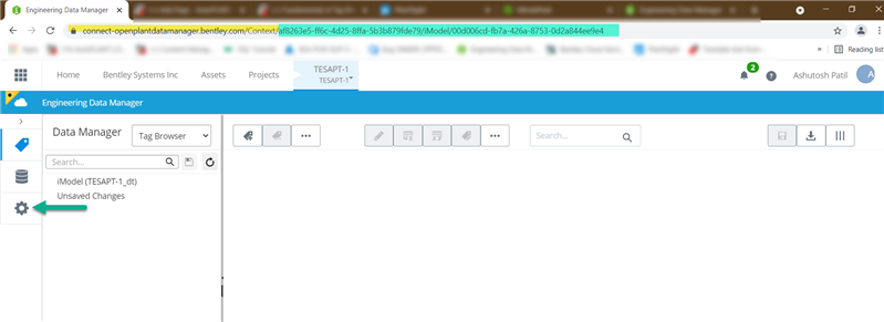

  7. Launch a new tag in browser and paste below link in it
    https://connect-openplantdatamanager.bentley.com/Context/
    and add further into it Guid of Plantsight project/iModel/ Guid of iModel
    Guid: af8263e5-ff6c-4d25-8ffa-5b3b879fde79/iModel/00d006cd-fb7a-426a-8753-0d2a844ee9e4
                                 PlantSight Project Guid                                      iModel Guid
    So overall link would be
    https://connect-openplantdatamanager.bentley.com/Context/af8263e5-ff6c-4d25-8ffa-5b3b879fde79/iModel/00d006cd-fb7a-426a-8753-0d2a844ee9e4

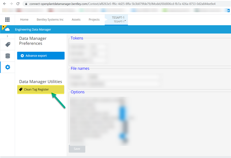

    Above link will load Engineering Data Manager window(EDM),Into it Click on Setting as shown in image below.
    And hit enter it will load Engineering Data Manager(EDM)
    Note: Kindly verify the access right if not able to get into it with Bentley.

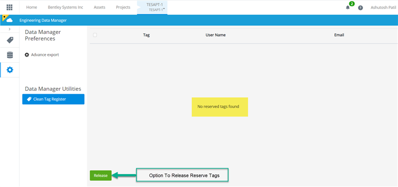

  8. After getting into Setting click on Clean Tag Register option.

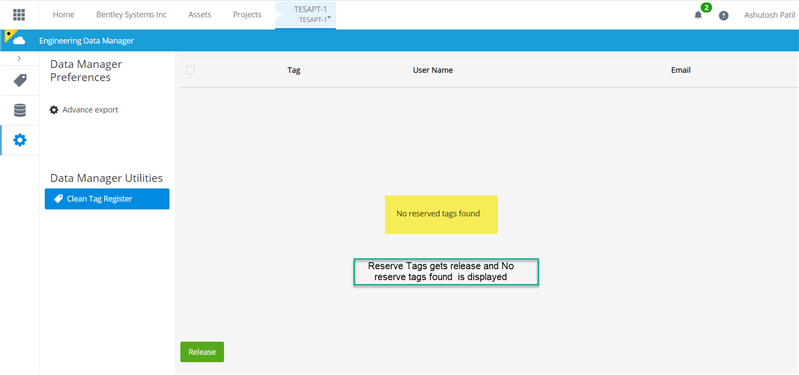

  9. Through Release icon user can release tag.
  10. Below just one tag got reserved so to free it, first select the tag i.e select  on that tag and then hit on Release
  11. After Tag gets released, “No reserved Tags found “ will be displayed
    In this way reserved Tags would be released.
