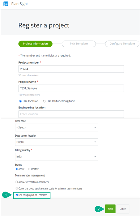

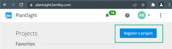

  1. Navigate the PlantSight portal and click on a Register Project.
  2. Fill in all the details in the Project Information & Check on a project on template as shown below.

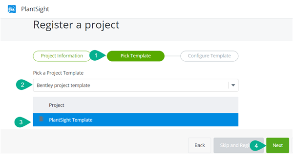

  3. From  Pick template, Select Bentley project template and use the default PlantSight template as shown below

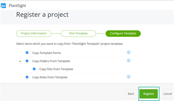

  4. Click on register a project, it will copy all default template rules, files, etc.

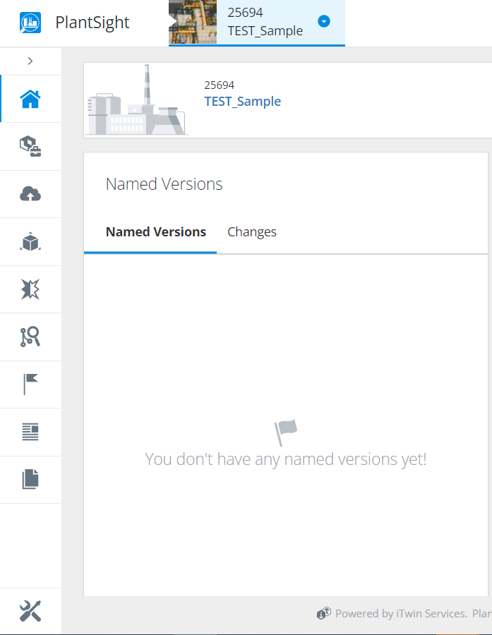

  5. It has created a new PlantSIght Project as shown below.
