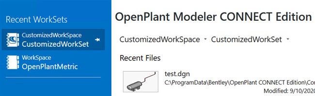

  2. Ensure to select the PlantSight enabled workset & open any desired model file. Please note that PlantSight enabled workspace will show different icon as shown below.

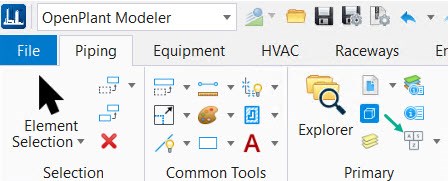

  3. Once model file is loaded, from Primary ribbon group, click on Key-in ribbon tool to evoke the Key-in command.
  4. Enter key-in value as mechaddin plantsight imodelinfo and enter to execute the key-in. Refer image as shown below.

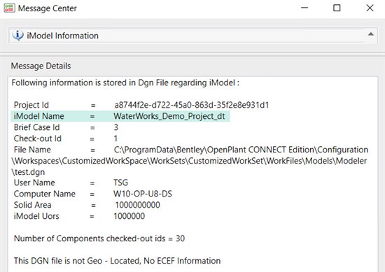

  5. Notice that to message bar, it prompt message as iModel Information. Click on i icon as shown below.
  6. Notice that, to detailed message we can find the entire details as shown below.
