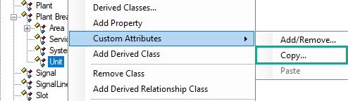

  3. Go to UNIT class, right-mouse click and select Custom Attributes > Copy as shown below.

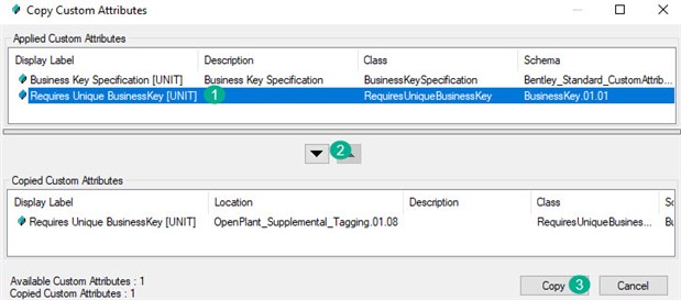

  4. From Copy Custom Attributes dialog, select Requires Unique BusinessKey custom attribute, using drop arrow move selected custom attribute to Copied Custom Attribute section. Click on Copy to copy the custom attribute.

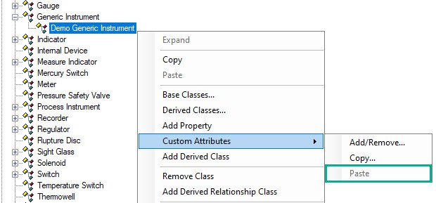

  5. Search for newly added class in this case its Demo_Generic_Instrument. Right click on the class and select Custom Attributes > Paste. Refer image as shown below.

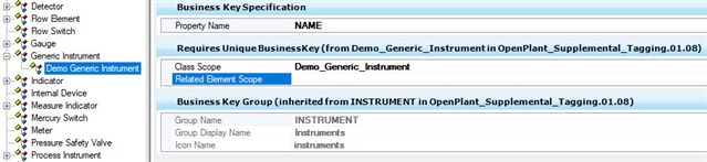

  6. Once pasted, enter exact class name to Class Scope under Require Unique BusinessKey as shown below.
  7. Save all the schema changes.

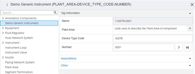

  8. Using OpenPlant Project Administrator, for modified workset perform Upgrade to push the latest schema changes to iModel.
  9. Load PlantSight Tag Management portal and notice that Demo Generic Instrument enlist for tag creation.
