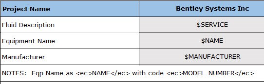

Template data-sheet format
In general, the spread-sheet format completely depends upon user requirement. The main details that should be taken care is about, how to map properties. Also, can we concatenate multiple properties?
To map a property $Property token will be used.
To include multiple properties, format will be used as <ec>Property1</ec> <ec>Property2</ec>
Notice that Equipment Name is mapped with $NAME, here $ is used as token and NAME is the property available in EC3 schema. Likewise, to include multiple properties notice that for NOTES couple of static text and two properties have been included.

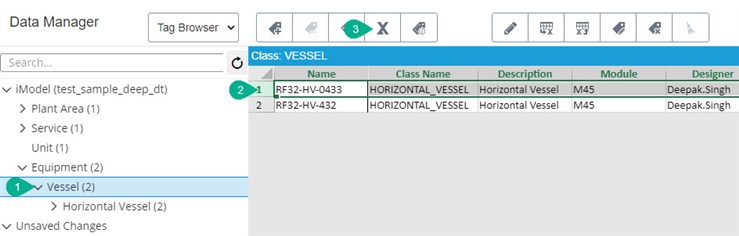

  1. Load Tag Management portal from PlantSight.
  2. From Tag Management portal, expand desired root node and select a tag row. Click on Advance Export, refer image as shown below.
    Note: Multiple records can also be selected, in that case select all the desired rows and click on Advance Export option.

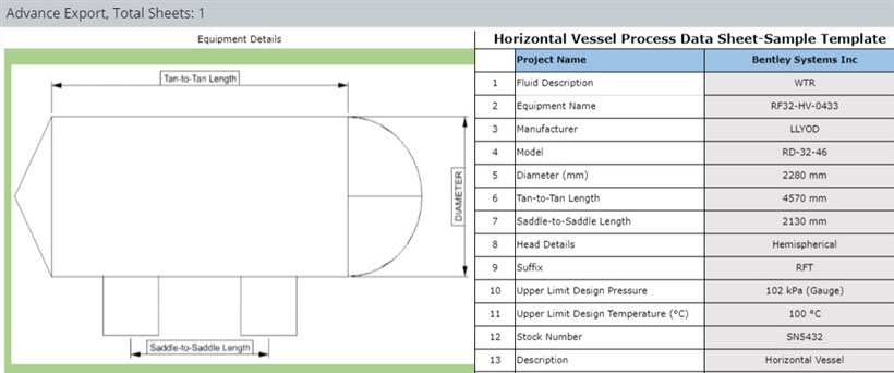

  3. It will prompt to select a template. Select desired data-sheet template. Refer image as shown below.
  4. Once data-sheet template is loaded, it will populate data-sheet with all the fields automatically, refer image as shown below.
  5. To the bottom of the page, options for Export and Print are available to save the populated data-sheet. Export Excel will download all the sheets. Print option will work for individual sheet per tag.
