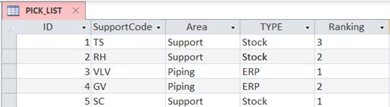

For example, below provided image shows column name of database as PICK_LIST. In this exercise we will select SupportCode values & based on selection Area, TYPE and Ranking value should show against DISCIPLINE, TYPE & SEQ properties respectively for support class.

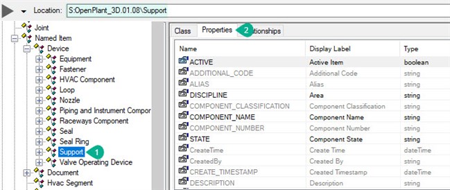

  1. Launch Bentley Class Editor CONNECT Edition.
  2. Load OpenPlant_3D.01.08. ecschema of your desired workset.
  3. Supplement with OpenPlant_3D_Supplemental_Modeling.01.08. ecschema  & OpenPlant_3D_Supplemental_ModelingViews.01.08. ecschema.
  4. Search SUPPORT class, switch to Properties tab, refer image below.

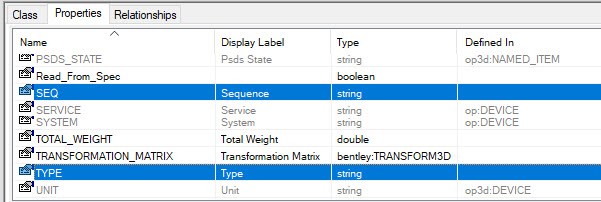

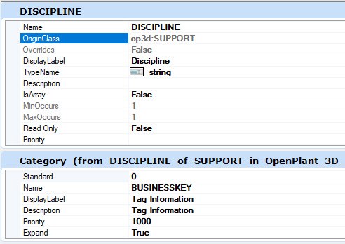

  5. Add below mentioned properties & add Category custom attribute to them. Refer image below
    DISCIPLINE
  6. Similarly, add SEQ and TYPE properties along with Category custom attribute defined to them. Refer image below

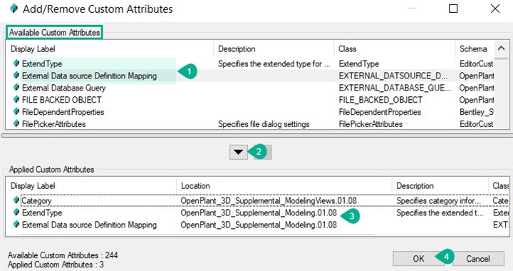

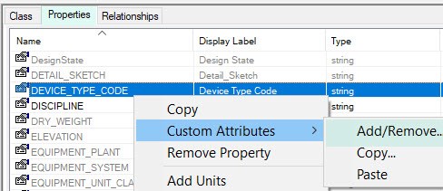

  7. Right click on DEVICE_TYPE_CODE property & select Custom Attributes > Add/Remove to add custom attributes. Refer image as shown below.
  8. From Available Custom Attributes section, select Extend Type and External Data Source Definition Mapping custom attributes. Using drop arrow add them to Applied Custom Attribute Ensure to change the schema location. Once done click on OK. Refer bulleted sequential steps.

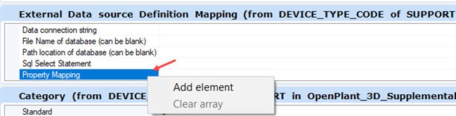

  9. For External Datasource Definition Mapping custom attribute, right click on Property Mapping & select Add Element to define mapping components, refer image below.
  10. Perform the same steps to four more time to add four records of mapping. Once done, it will look like as shown below.

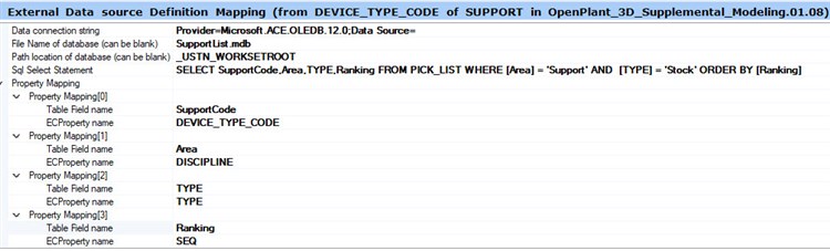

  11. Enter details for External DataSource Definition Mapping custom attribute as mentioned below.
Data connection string: Provider=Microsoft.ACE.OLEDB.12.0;Data Source=
File Name of database:  SupportList.mdb
This is the name of database file, in this exercise database file name is SupportList.mdb

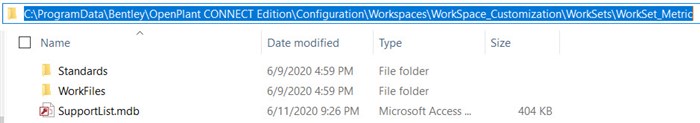

Path Location of database: _USTN_WORKSETROOT
This ask to point to location of database file, in this exercise database file is located as workset location, refer image below.
Note: Make sure there is no space before _USTN_WORKSETROOT.
SQL Select Statement: SELECT SupportCode,Area,TYPE,Ranking FROM PICK_LIST WHERE [Area] = 'Support' AND  [TYPE] = 'Stock' ORDER BY [Ranking]
Property Mapping [0]
Table Field Name: SupportCode
EC Property Name:
DEVICE_TYPE_CODE
Property Mapping [1]
Table Field Name: Area
EC Property Name: DISCIPLINE
Property Mapping [2]
Table Field Name: TYPE
EC Property Name:
TYPE
Property Mapping [3]
Table Field Name: Ranking
EC Property Name:
SEQ
  1. Once desired inputs are added it will look like as shown below.

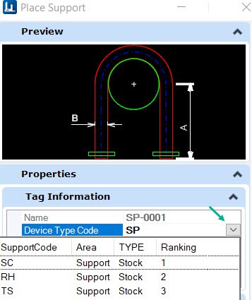

  4. Load OpenPlant Modeler CONNECT, route a pipe & place support on it.
  5. Notice that, for DEVICE Type Code it enlists the list of filtered record based of SQL query from database. Refer image below
  6. Select RH record & inspect the properties value that should update automatically.
  7. Notice that, rest properties get updated automatically as shown below.
