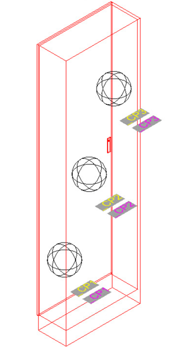

Support for Multiple Connection Points on Equipment
You can add multiple connection points to equipment using the new Parametric Content Creation tool. You can use the "Point" primitive and set its type to "ConnectionPoint."
In essence, this feature adds junction boxes as additional connection points to the equipment. The cable list should then refer to the IDs of these connections, which would be automatically labeled as: "(equipment ID)+(Name property of Point node in POB file)." The cable routing would then identify which connection point to route a cable to.
