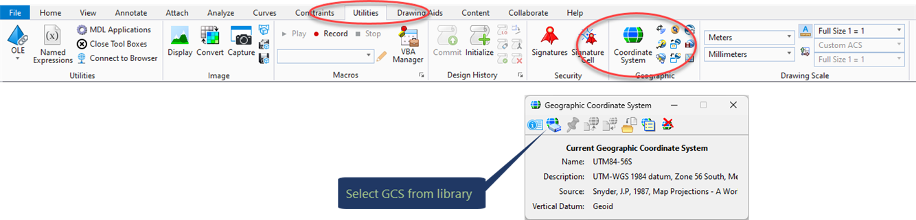

MicroStation:
- Create a new DGN file
- Open the Utilities tab and select the Coordinate System tool
Image 1 - MicroStation geographic coordinate system menu
- Pick or search for the correct coordinate system
- The DGN does not require any content and can remain empty

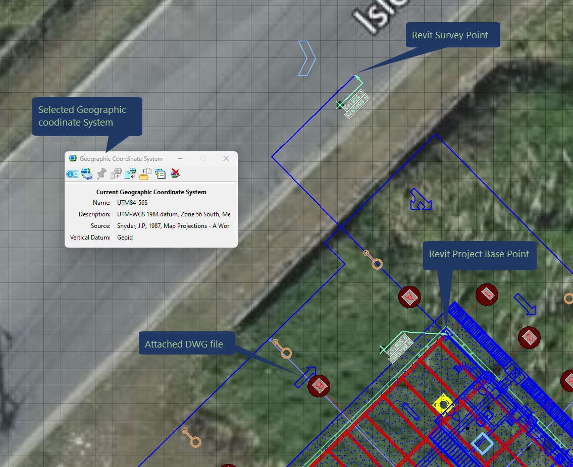

Unless previously provided by a qualified surveyor, it can be difficult to select the correct GCS. In some cases, a standard UTM zone can be used. In the above example, UTM84-56S has been selected. Exporting a site drawing from Revit as a DWG and attaching this drawing to MicroStation can be useful to verify the GCS selected and correct placement.
Once attached to MicroStation and with the background map enabled, the attachment should be located at the desired position.
Image 2 - MicroStation with attached DWG
