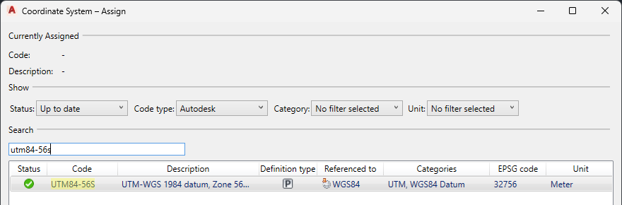

Civil3D:
- Create a new DWG file
- Use command MAPCSASSIGN
- Select the appropriate geographic coordinate system (i.e.: UTM84-56S)
Image 1 - C3D Coordinate System menu

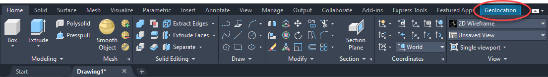

- Once a valid coordinate system has been selected, the Geolocation tab will become available
Image 2 - C3D Geolocation tab
- Turn on the background map and visually check that the correct area is visible
- Save the C3D file

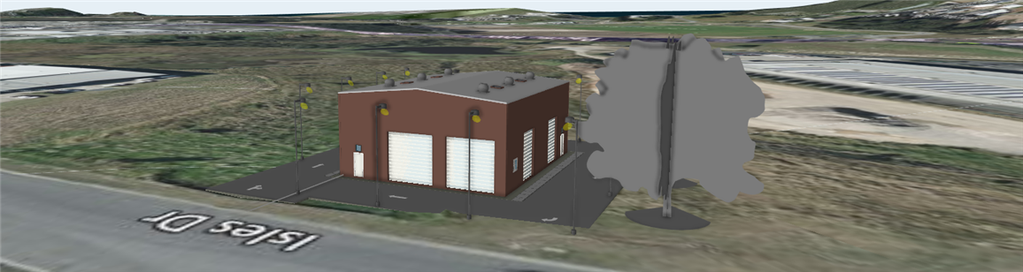

Image 24 - Correctly positioned Revit model using a C3D geolocation file

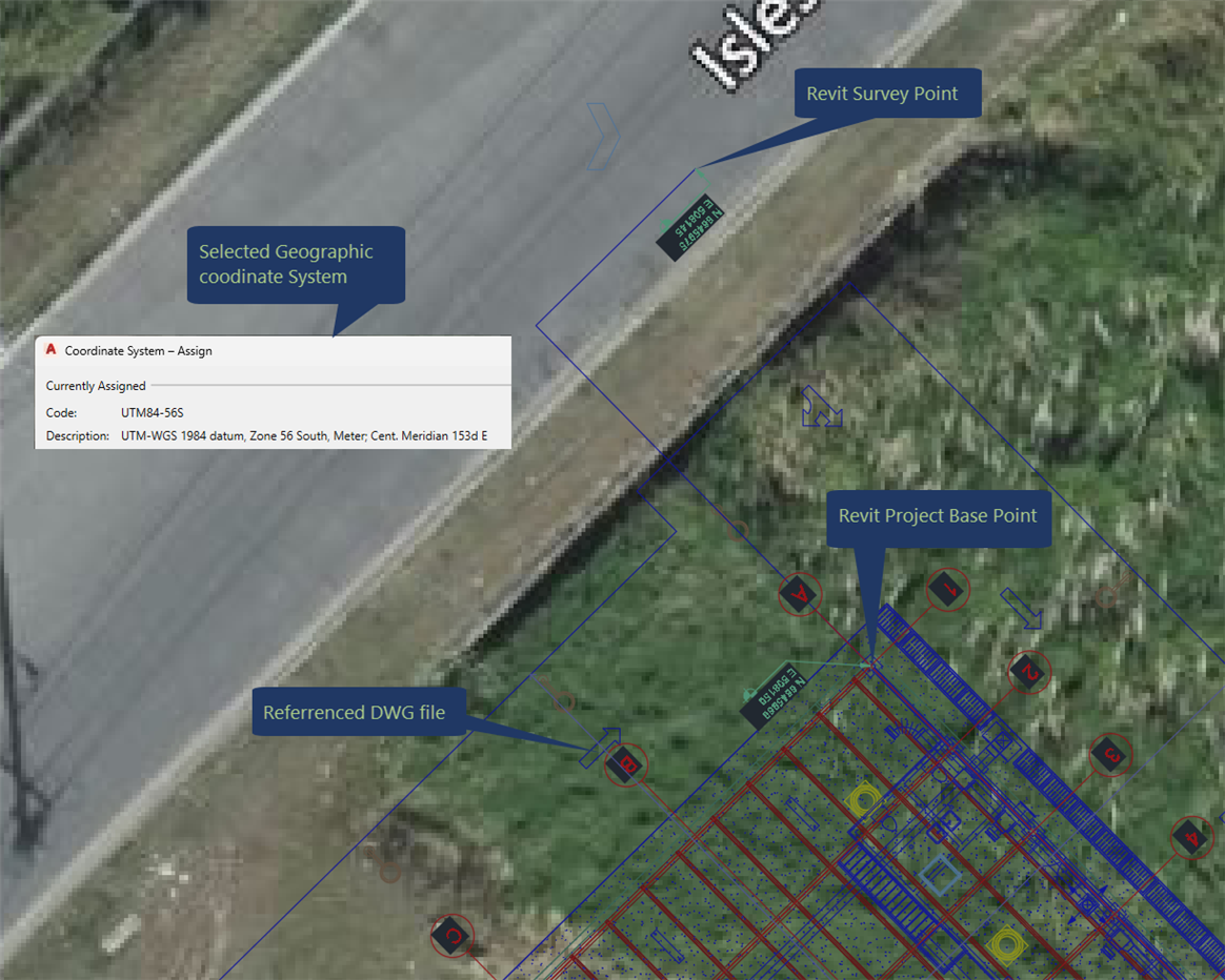

Validating Results
Unless previously provided by a qualified surveyor, it can be difficult to select the correct GCS. In some cases, a standard UTM zone can be used. In the above example, UTM84-56S has been selected. Exporting a site drawing from Revit as a DWG and referencing this drawing to Civil3D can be useful to verify the GCS selected and correct placement.
Once attached to Civil3D and with the background map enabled, the reference should be located at the desired position.
Image 25 - Civil3D with referenced DWG
