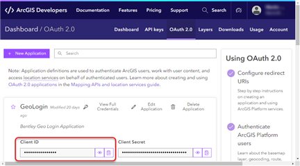

Step 1
Create a new Geologin Application in the ArcGIS Developer site and copy the Client ID to the clipboard.
This step is mandatory. Registering the GeoLogin application in ArcGIS allows to authenticate ArcGIS users and access user content on behalf of authenticated users

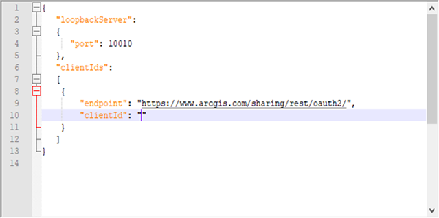

Step 2
Paste the Client ID in the GeoLogin.config.json file located in C:\Users\User.name\AppData\Local\imodelbridges\GeoBridge
Save the file.

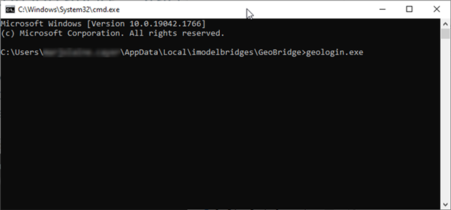

Step 3
Launch a Windows command prompt and go to the following location and type Geologin.exe
C:\Users\User.Name\AppData\Local\imodelbridges\GeoBridge

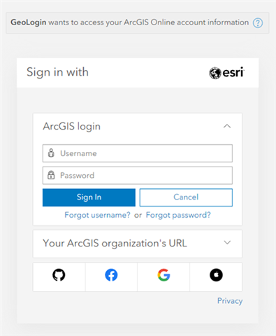

A new web browser is launched, showing the ESRI Login page.
Type in your ArcGIS credentials and click Sign In.

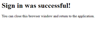

Step 5
Once the login is a success, a new web page is launched and displays the following message:

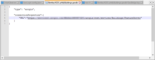

You are now authorized to synchronize your ArcGIS Feature Service layers that are stored in your ArcGIS Server.
In this case, a .geodb file is used to define the URL pointing to your ArcGIS Feature Service and filter the features to be synchronized, if required.

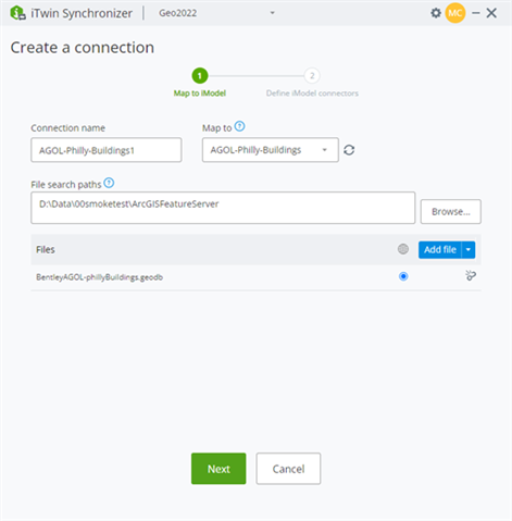

Step 7
Run the iTwin Synchronizer client application and select the .geodb file that contains the URL that points to the ArcGIS Feature Service.
The Geologin program should be run each time the iTwin Synchronizer is re-opened and a .geodb file that contains ArcGIS FeatureServer URL that requires authentication is processed.
