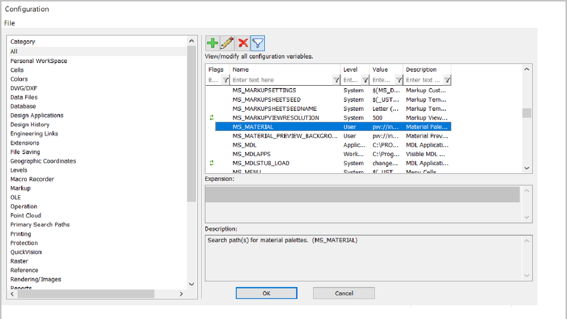

Material could not be located or could not be loaded
The file has configured materials, that can not be located. Please check if the path to Materials is located in ProjectWise and is accessible.
In Bentley Civil product files, this can be checked by opening a dataset with materials and textures from ProjectWise.  In opened file first, check if there are any errors in the Message center.
If you see an error coming for missing materials then open "Search Ribbon" and type "ConfigurationVariable"
Now visit the same path in the ProjectWise location and check whether you have a materials folder available.  NOTE: Materials located in the local machine path are not supported by the cloud Synchronization solution.
If you don’t see the materials folder in a specific path (under workspace configuration) > Open the locally available workspace folder deliverable with Civil product which is under
C:\ProgramData\Bentley\OpenRoads Designer CE\Configuration\Organization-Civil and copy materials folder under the required ProjectWise path.

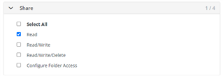

Project Share Permission Missing
The Connection owner does not have enough Project Share permissions. Please check project-level permissions.
Manage Project Team Members -> Project Role Management -> Service Access and Permissions -> Share -> Read
