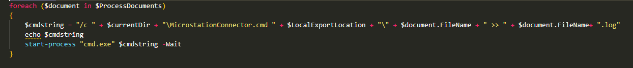

  6. Process them
A command file is used invoke the connectors but this is personal preference as attempting to debug the command line with PowerShell I found frustrating.
The full command file for Microstation is here:

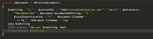

Use ProjectWise Directly
The connectors also allow a ProjectWise GUID to be passed to them. Therefore, if we wanted to have the PW link, we need to set the DMS parameters.
--dms-inputFileUrn="%1%" ^
--dms-user="glen.worrall@bentley.com" ^
--dms-type="1" ^
--fwk-staging-dir=F:\staging\PWTemp ^
--dms-workspaceDir=f:\staging\workSpace ^
Modify the PowerShell script accordingly:
 And we have the same iModel.
This time with links back to the pw repository.
