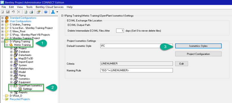

  1. Open Project Administrator. Select Root and Project, Settings, and Isometric Styles.

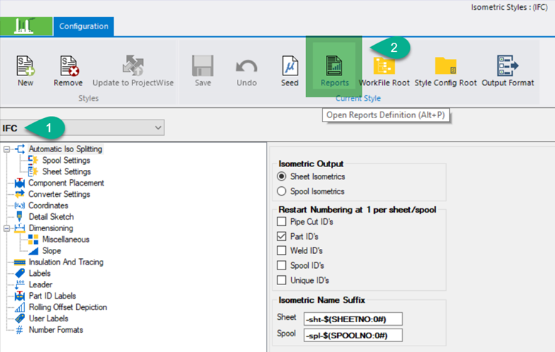

  2. Select Isometric Style and go to Reports. Report.def will open.
    Note: User can navigate through the Root and Project folder for report.def file. Refer to image below.
  3. Add the given values in report.def file.
