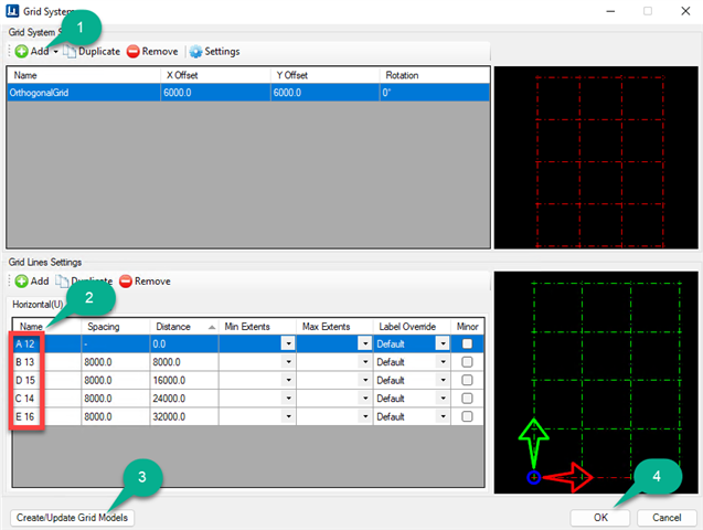

In OpenPlant Modeler after creating a Pipelines on a Grid and try to generate an isometric shown the error as shown in imager below.
Follow the below steps to resolve this issue.
Steps to Resolve
  1. Launch OpenPlant Modeler
  2. Activating the Column Grid from Custom Ribbons Click on the icon as stated in image below.

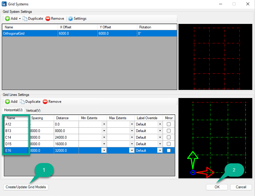

  3. In the Gridline setting noticed horizontal and vertical name of the grids have space in it. Remove the Spaces between Alphabet and Number save the settings.

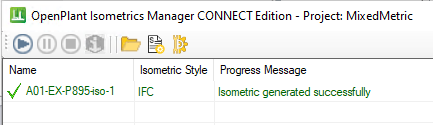

  4. Generate the Isometric again and notice the isometric has generated successfully as shown in image.
