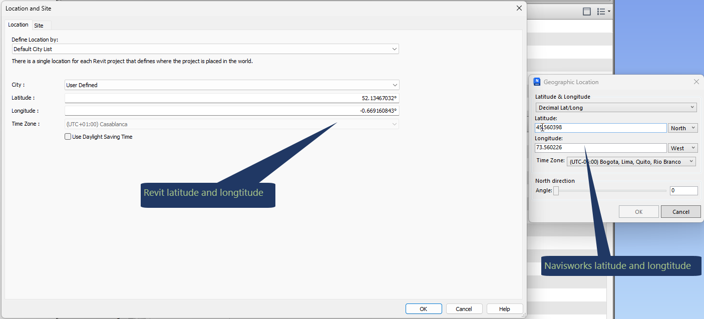

Default Navisworks location
Just like Revit has a default location, frequently somewhere in the environs of Boston, Navisworks appears to come with a default location in Montreal. Synchronizing an Navisworks file directly will position the model either in Montreal or at a recalculated position, depending on the source file information. As a result, even a perfectly geolocated Revit file might not be aligned correctly when appended to Navisworks and synchronized as an NWD.
Note that it is possible to ignore the defined latitude / longitude values set in the Navisworks models when they are synchronized. You may want to explore this as an option if you synchronize Navisworks models and they are located far from the rest of the content of your iModel. You can also edit the Navsiworks data to match other Navisworks models that are being synchronized, but if you don't have access to the Navisworks software to make these edits, then ignoring this data may be a better option. To get this setting enabled, please contact support and mention that you would like nwd-ignore-inputfile-geodata enabled for your iModel.
Image 1 - Revit and Navisworks coordinates
Local Grid Coordinates
All appended files must be spatially positioned correctly and have local X and Y coordinates. This applies to any format. For example, IFC files must be exported from the authoring applications with X and Y coordinates. Only spatially aligned models will be positioned correctly.
