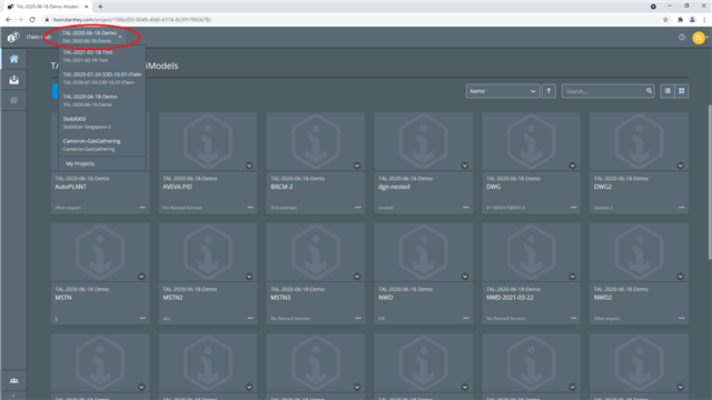

Navigate to https://iTwin.bentley.com
Select your iTwin if you don’t see the iModel you want to export to IFC.
Once you have your iModel, you have two choices for where you can initiate IFC Exports.

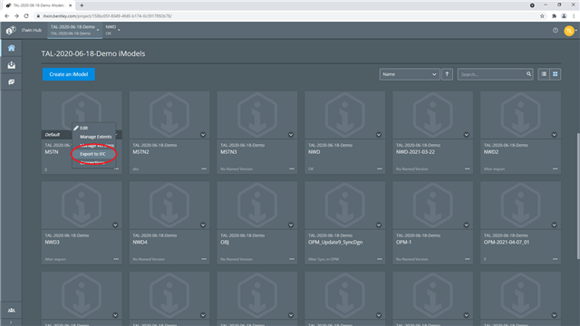

Exports from iModel List
Once you see the iModel you want to export, click on the three dots. Select the Export to IFC menu item.

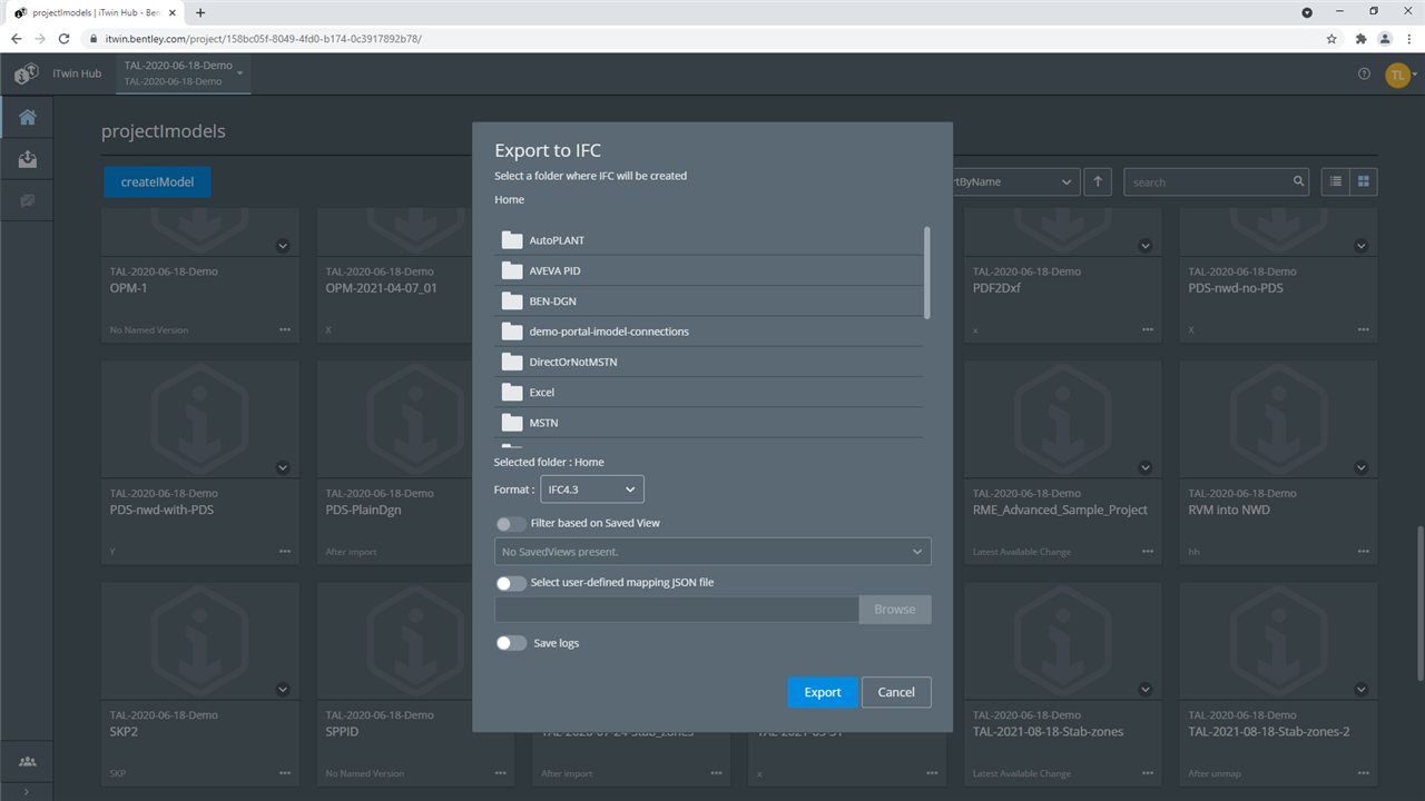

This brings up the Export to IFC dialogue.
Export based on Saved View:
Toggle the "Filter based on Saved View" to create the IFC export based not on the entire iModel, but based on one of the saved views defined in Design Review. This can result in a much smaller IFC file which can be particularly useful on very large models.

Common Options
Optional Log file:
You can also optionally pick to have the log files copied to the same location as the generated IFC file by toggling "Save Logs"

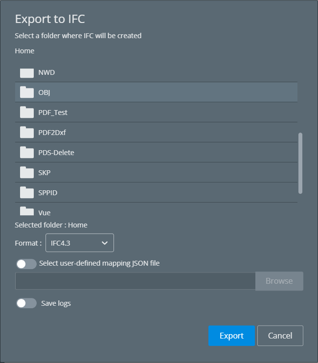

IFC Format:
Select the IFC format. Currently supported formats are IFC 4.3, IFC 2X3, IFC4 RV 1.2, IFC 2X3 CV 2.0 and IFC 4.3 ABV.
User defined Mapping
Optionally, you can select a custom mapping file to be used for the IFC Export. A base mapping file can be found here:
Schema mapping

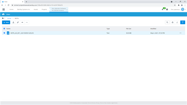

Once you click on Export, a message will appear near the top of the window:
You will receive an email once the IFC file has been generated. Go to the Project Share and download the file.
