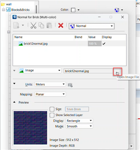

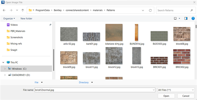

Warning: DgnV8_0057
   Warning message: "The texture 'File_Name.jpg' used in material 'Material_name' used in file '1-1111-S-001' either could not be located or could not be loaded."
Issue:
Cause:
The textures can be solved by fixing the paths of textures (PNG\JPG) files used in materials using the Material Editor dialog in the Bentley design application. The dialog can be launched using search-> Material Editor.

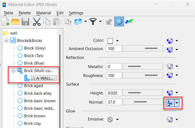

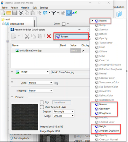

Warning: DgnV8_0063,DgnV8_0064
Info Message DgnV8_0063: Texture 'C:\stagingDir\d0246137\TextureFile.jpg' for material 'Material' is of unsupported PBR material type.
Info Message DgnV8_0064: The texture 'C:\stagingDir\d0246138\TextureFile.jpg' in material 'Material' uses 'Solid' mapping mode which is unsupported. The material will be dropped. Please change the mapping mode to a supported mode.
Material types and texture mapping modes
There are numerous techniques for texture mapping, such as cubic, cylindrical, directional drape, elevation drape, front projection, parametric, planar, solid, spherical, and many other complex methods and variations. However, iTwin connection synchronizations are limited to supporting only three of these texture mapping modes. If materials with unsupported texture mapping methods are used in iModels, a Visual Fidelity warning will appear in the Synchronization Report, indicating that 'The material will be dropped. Please change the mapping mode to a supported mode.'
Supported texture mapping modes in iModels:
More information about each mapping mode:

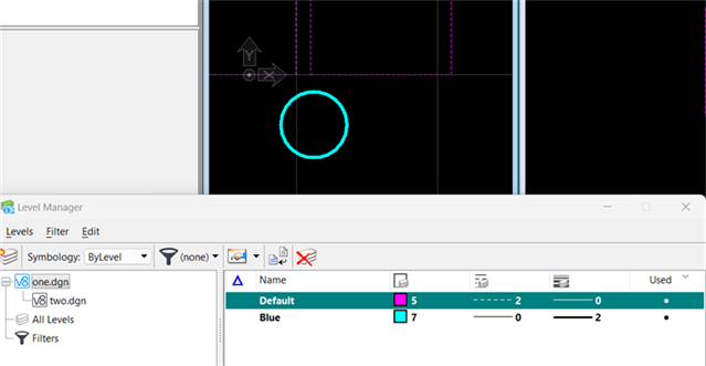

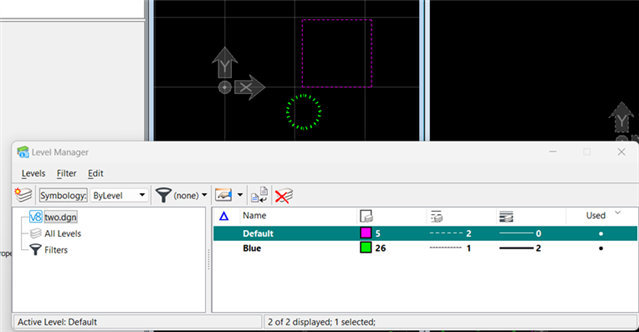

Level
Info:DgnV8_0044
   Info message: "Level [Level name] has a different definition in [path name] than in other files or attachments: weight/color/style (x vs. y).""
Issue:
Same name level carries distinct values across associated files.
Cause:
Level sharing the same name across related files which have different definitions for line color, weight or style.
Either modify the level names or ensure consistent definitions for levels with identical names.
Example:
Same name "Blue" sharing levels has different definitions for color and style.
MicroStation documentation related to levels: https://bentleysystems.service-now.com/community?id=kb_article&sysparm_article=KB0113400
