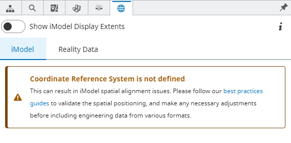

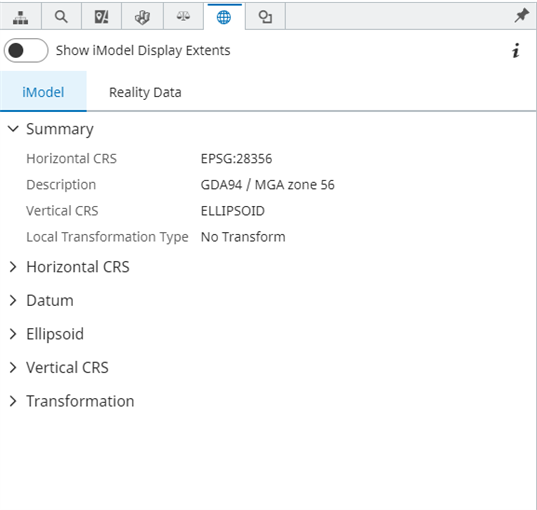

The iModel tab shows geolocation information about the loaded iModel. The expectation is that every iModel can be positioned at one permanent location on the earth. The warning will be displayed if no location information is available, as in an image.
Image 3 - no Coordinate Reference System warning

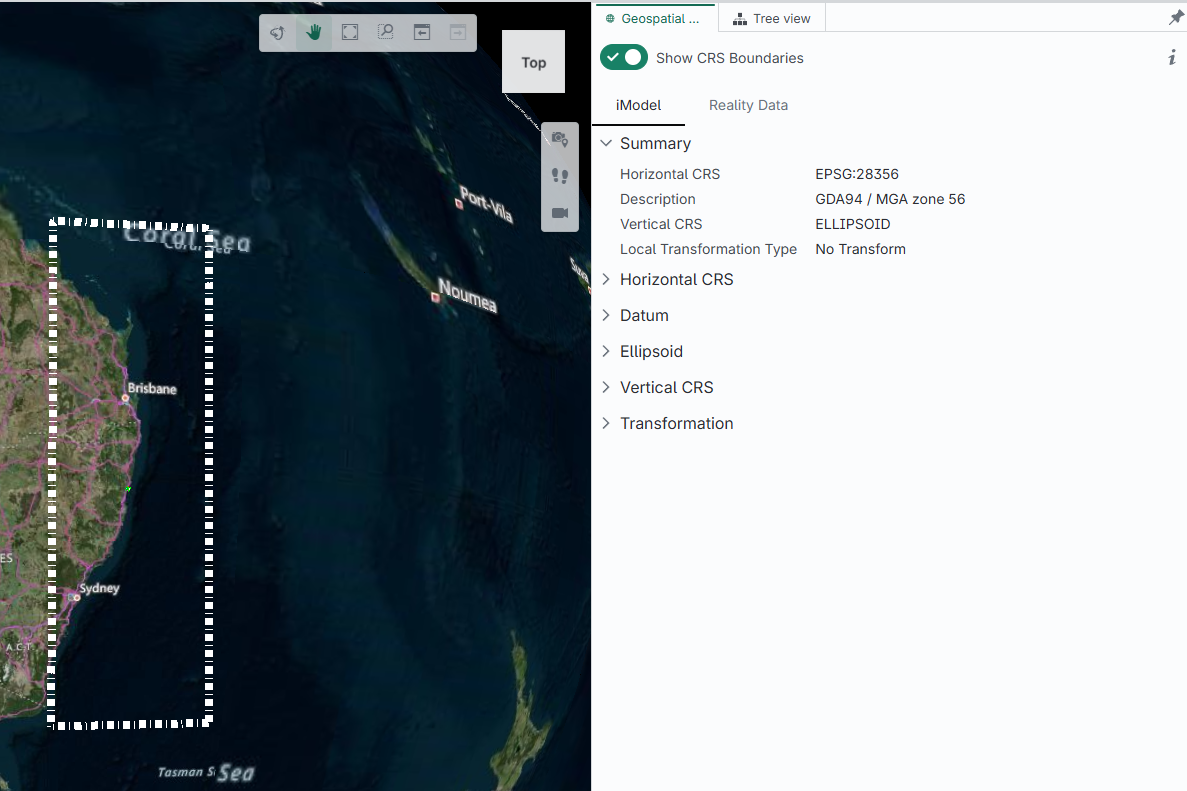

If iModel has a valid Coordinate Reference System, you can view its boundary by enabling the Show CRS Boundaries toggle. Note that world coordinate boundaries are not shown.
Image 3.1 - Coordinate Reference System boundaries
If you want to understand how geolocation is set for iModels, more information can be found in the iTwin.js documentation, including the description of each available property. Below is a short summary of key elements:

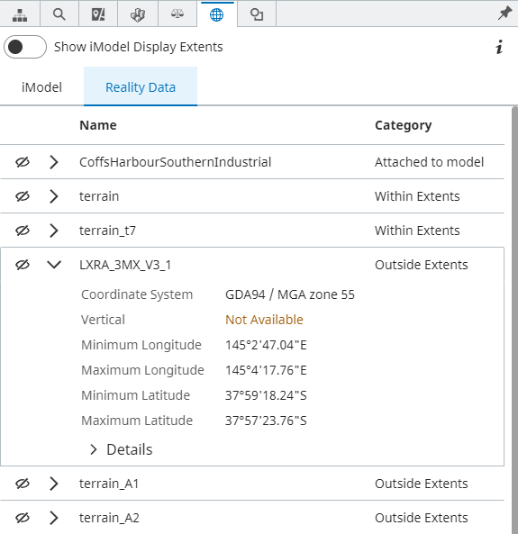

The Reality Data tab shows geolocation information about reality data related to the loaded iModel or the iTwin. You can sort or filter by Name or Category: Attached to model, Within Extents or Outside iModel Display Extents, and expand the instance to see each geographical reference system information as shown in the image.
Image 4 - Reality Data CRS example

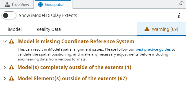

It is crucial to define the Coordinate Reference System to ensure accurate spatial positioning of iModel. Without defining it, iModel might have a wrong or random location on the earth's surface, which can result in misalignment and other spatial issues (Image 5). Thus, it is recommended to follow the best practice guides to validate the spatial positioning before synchronizing your engineering data. Please note that a similar warning will also be displayed in the iModel tab (Image 3).
Image 5 - iModel missing CRS warning example

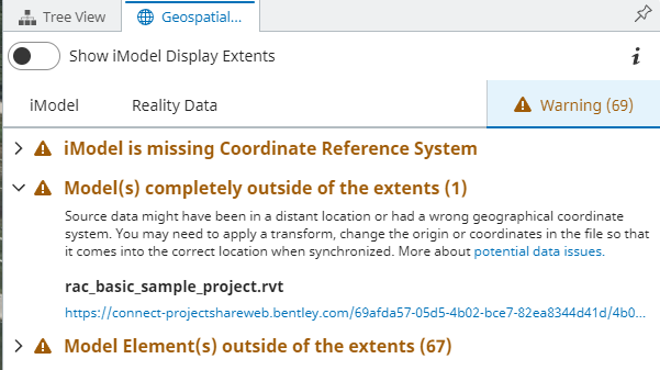

If one or more models are not visualized and are entirely outside the iModel Display Extents even though they appear in the Tree View, a warning message will specify the excluded models (Image 6). To learn more about iModel Display Extents and potential issues, visit this link.
Image 6 - Model outside of iModel Display Extents warning example
