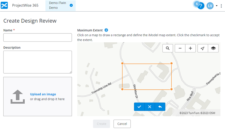

When you create an iModel in various Bentley products, you might have seen functionality to define Maximum Extents as 2D rectangle. We always recommend setting those up, as this will optimize viewing performance, making elements outside the interest area not shown. Refer to the Potential data issues chapter to learn more.
Image 1 - Maximum Extents example in ProjectWise 365
If you synchronize files using iTwin Connectors, the actual Extents will be statistically determined based on your data (as long as it is within the defined Maximum Extent area), and it could be smaller than the area you set up as Maximum Extents. In subsequential synchronizations, when a lot of new data is found, the original Extents might be adjusted to cover the probable new interest area.

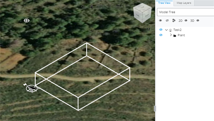

Please refer to the individual product documentation to determine if and where such Extents functionality is exposed in the interface. For example, in some viewers, that might be under Diagnostic Tools, as shown in an image, or as part of the Geospatial Metadata panel widget.
Image 3 - Extents exposed in Design Review

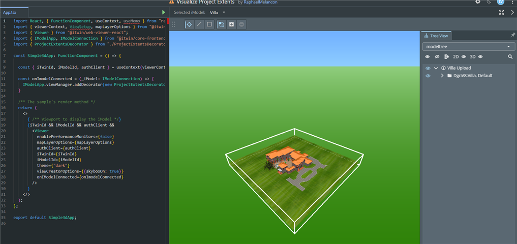

For developer resources, you can find more documentation on the iTwin.js iModels overview page or try the "Visualize Project Extents" sandbox.
Image 4 - Visualize Project Extents sandbox

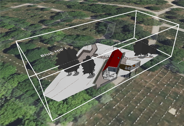

Partially visible data on iModel
There could be different reasons if you notice missing models when visualizing the data.

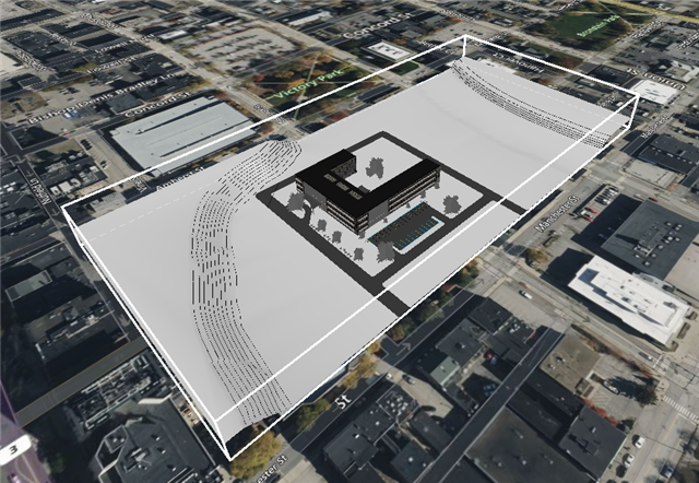

- If the whole model is not visible, it is possible that the source file was in a distant location or had a wrong geographical coordinate system. You may need to apply a transform to place it correctly or change the origin or coordinates in the file so that it comes into the correct location when synchronized.
- If some data from iModel looks like 'cut,' it is possible that the wrong spatial root file was specified, resulting in false original Extents values. You may need to adjust the Extents to match the boundary of the project as needed.
Image 5 - Partially visible iModel
Image 6 - Models or all iModel is outside of Extents
