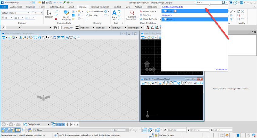

1. Open the Bentley Design application (for example MicroStation, OpenBuildings Designer, or any application you are using) and please type Key-in in the Search Ribbon.

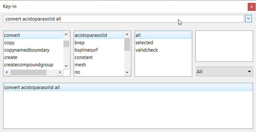

2. Type convert acistoparasolid all.

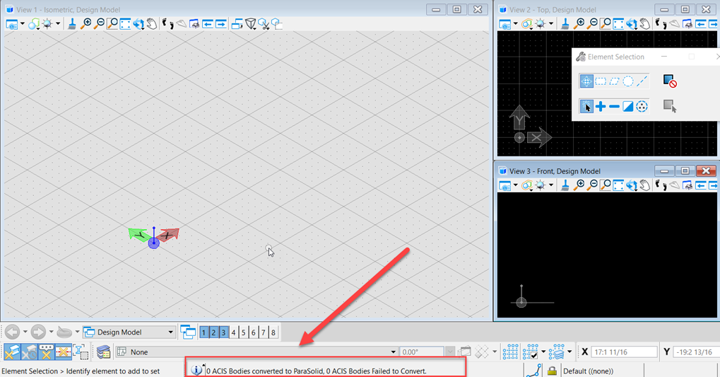

3. Click Enter and on the lower ribbon you will see if and how many ACIS elements have been converted.
