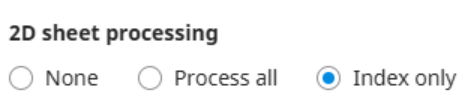

Warning message: Attempted to filter sheets by sheet index, but no sheet index was found!
Issue:The following warning occurs when the connector is configured to filter sheets by a sheet index, but no sheet index could be found or loaded for the job. When this happens, the connector does not apply sheet-index filtering; instead it falls back to discovering and processing all linked drawing/sheet files (as if no filter were set).
Cause:
When sheet-index filtering is enabled in the connection:
The connector tries to load a Sheet Index (DgnLinkTree). It looks in this order and fails to find one in any of them:
  1. The SheetIndexPath provided in the job definition.
  2. The config variables _USTN_WORKSETDGNWS or _USTN_WORKSET_DGNSI.
  3. A .dgnws (workset) or .dgnsi (sheet index) file in the workspace directory.
  4. The root file's own sheet index tree.
Common reasons: the sheet index / workset file isn't delivered with the dataset or workspace, the SheetIndexPath is wrong or empty, the config variables point to an invalid/missing file, or the source simply has no sheet index defined.

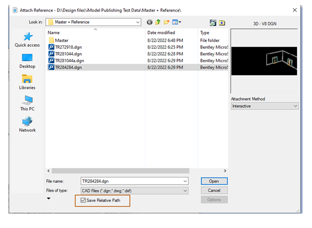

Warning: DgnV8_0132
Warning message: "Reference attachment (.dgn) is missing from reference or master model .dgn"
Issue:
Reference attachments cannot be found in the defined location and can not be synchronized. As a result, the iTwin doesn't show all the input files (Master or References) in iModel Index or visibility tree in Desing Review.
Cause:
Image 1
Warning: DgnV8_0133
Warning message: "Reference model <File_Name> is ignored because its display is turned off in the master model."
Setting the reference file's display off in the master file is a common practice in various software applications, especially in computer-aided design (CAD) and 3D modeling environments. This is often done to simplify the view, optimize performance and file size, and reduce visual distractions. The synchronization logs this information and provides it for any potential issues analysis in the synchronization report.
Issue:
Reference files are missing in the iModel.
Cause:
The reference file's display is turned off in the master model.
Open the source file in the Power Platform application where the source file was created (MicroStation, OpenBuildings Designer, or other). Go to Home -> References. In the opened References dialog notice that some references do not have a checkbox selected in the Reference Display column. (Highlighted in green in the below image.) This means that the display is turned off.
If you need these references to be synchronized to the iModel, update the display setting in the source file, save the changes, and reprocess them to the iModel.
If you do not want to process the disabled references to the iModel, please ignore this warning.

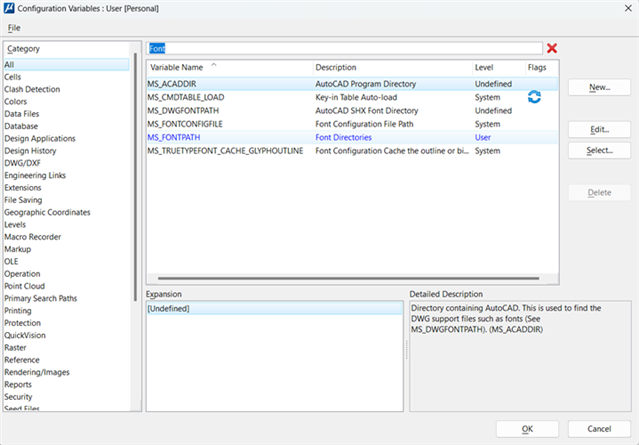

Non-default fonts using in iModels

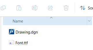

While working with connectors a user might want to choose a non-default font for drawings but font iModel embedding is working differently between various integrations. This will help them to place fonts correctly, make that fonts would be embedded properly and avoid errors related to missing fonts. In this article, we will see where to place font files that they would be visible in iModels.
Fonts using in Connect Portal Files Share or iTwin Desktop Synchronizer documents synchronization
Non default font file can be simply placed to the same directory as design file, and it will be embedded to the iModel.
Fonts using in Connect Portal and Bentley Infrastructure Cloud Portal ProjectWise documents synchronization
When a non-default font file cannot be found in iModel, placing font file to the same directory as a design file or trying to Scan References in ProjectWise would not help.  Font file should be supplied via WorkSpace, it should be placed to directory, where used workspace variable MS_FONTPATH is pointing. Configuration variable MS_FONTPATH specifies a list of directories that are searched to locate fonts. Usually default font location is: C:\Program Files\Bentley\MicroStation CONNECT Edition\MicroStation\Default\Fonts. Configure variable by additionally inserting another location where non default font is placed, and connector will use that font for iModel.
You can access Configuration Variables dialog in MicroStation from the following:
Ribbon: File>Settings>Configuration>Configuration Variables
MicroStation CONNECT EDITION documentation about using fonts: https://docs.bentley.com/LiveContent/web/MicroStation%20Help-v19/en/GUID-EA4472D6-C3D4-F8CB-1D63-517F1E3B7575.html
