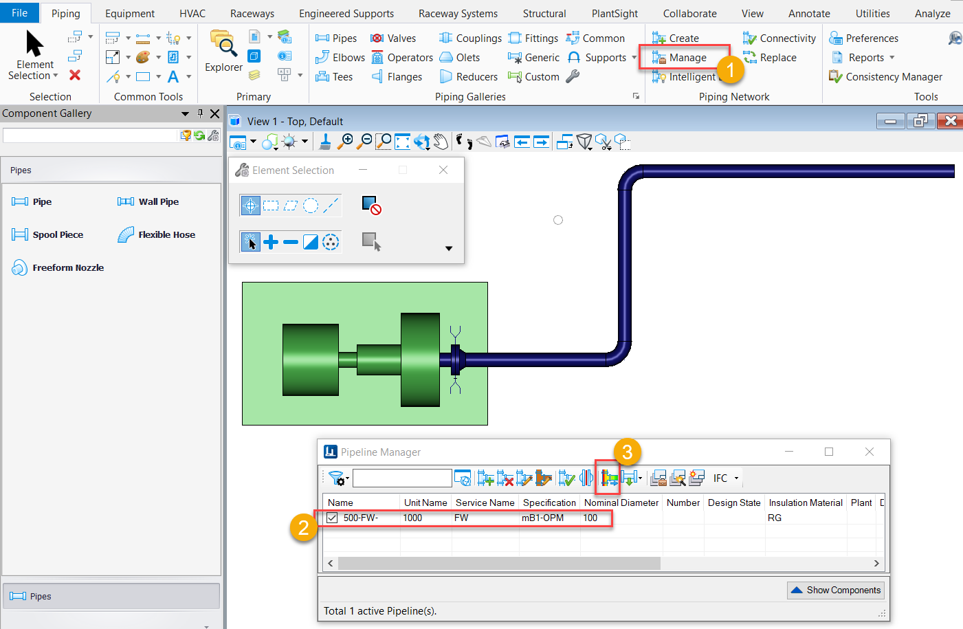

  2. Draw the desired pipe model
  3. Launch Pipeline Manager(1), select the pipeline to be exported(2), click on Export data for stress analysis(3)

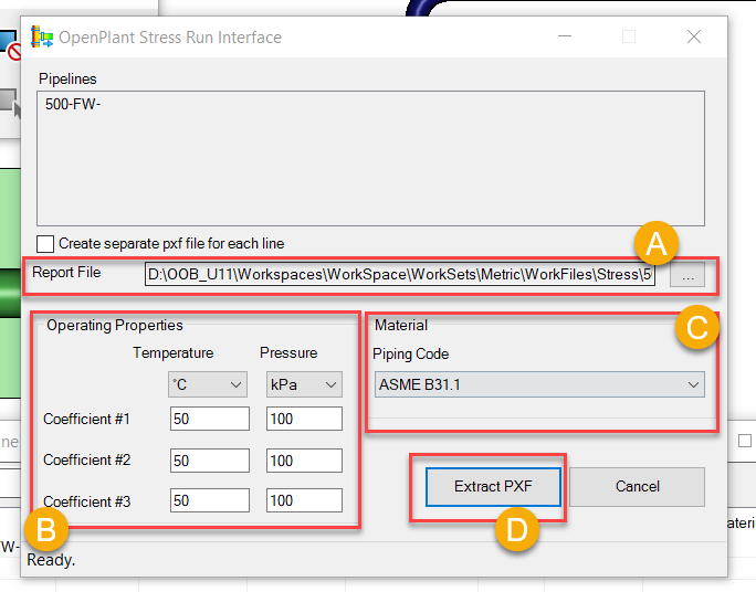

  4. The dialog for the export will open,
    1. Take not of the export location
    2. Make sure to put values to the Operating Properties
    3. Choose the material based on the code list
    4. extract PXF
  5. Check the export location for the PXF file
