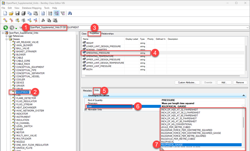

If unit of measurement displayed in Element information dialog need to be changed, than this article helps to do that.
- Start Bentley Class Editor
- Open 01.08 Schemas
- Find class which needs to be modified, in this case we will be modifying PRESSURE for equipment
- Go to Properties Tab
- Scroll to Operating Pressure
- Go to Units Tab
- Change Units from given option
- Save and Close
