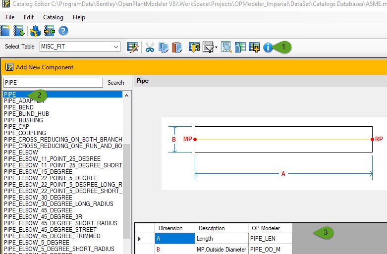

Case#1
List of Piping components available in Component Table:

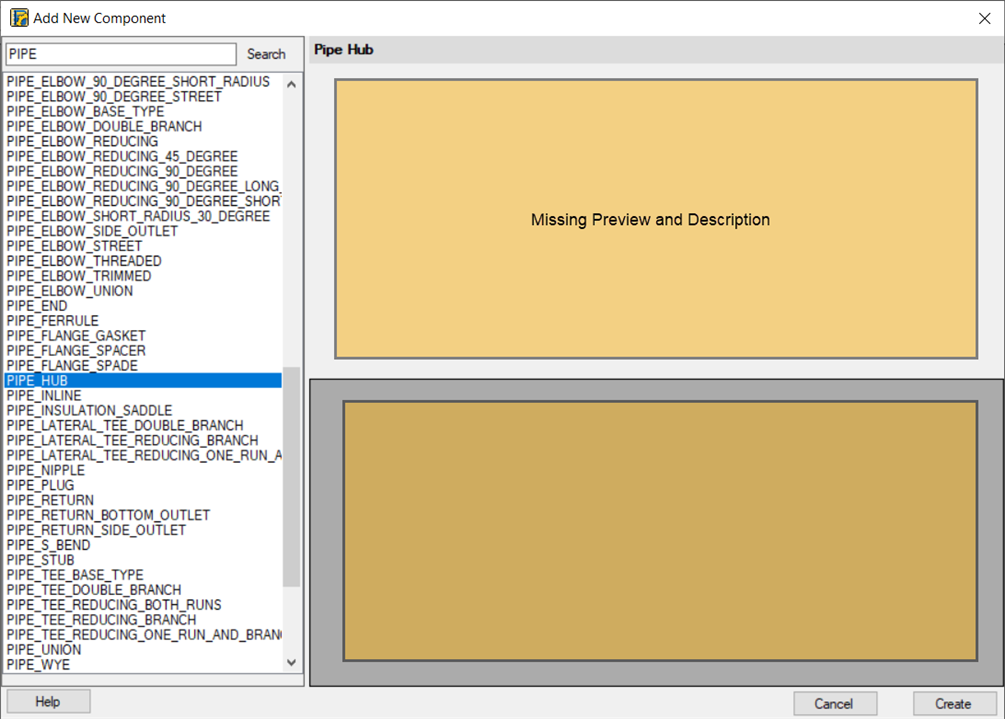

CASE #2

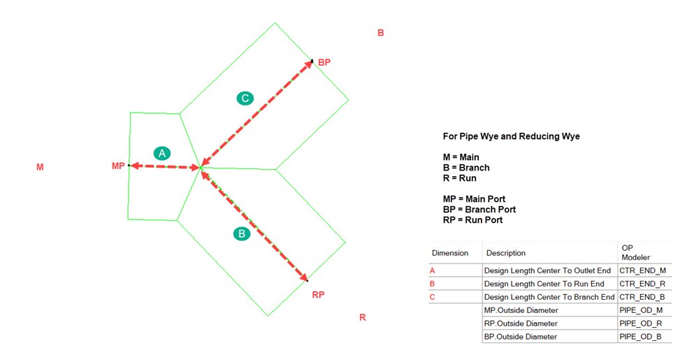

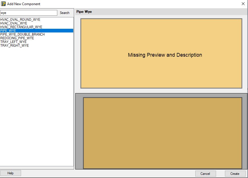

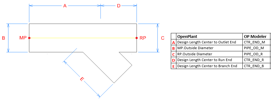

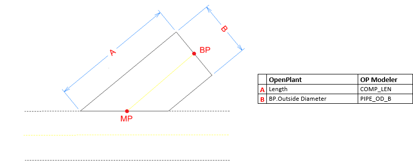

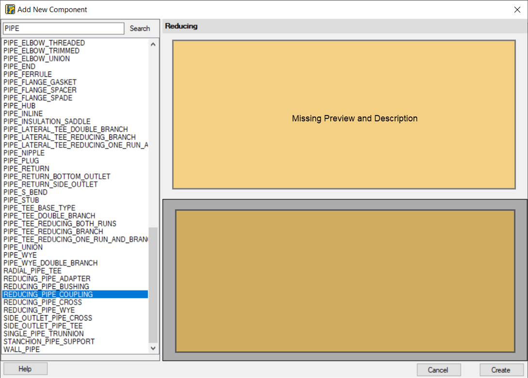

User has also mentioned about some other components like Pipe Wye ,Pipe Hub,Pipe Coupling , Pipe Bend and Reducing Pipe Coupling which do not have their respective preview and description
It has also been observed that there many components that do not have respective preview and description. This is causing issues for many users as they are unable to create custom components.

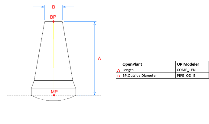

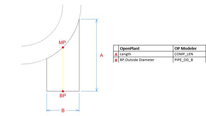

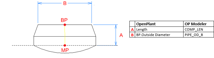

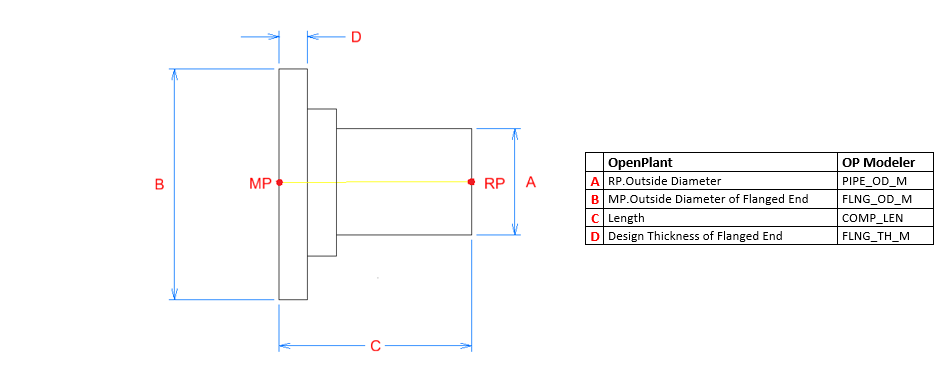

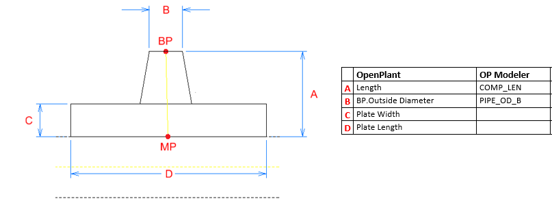

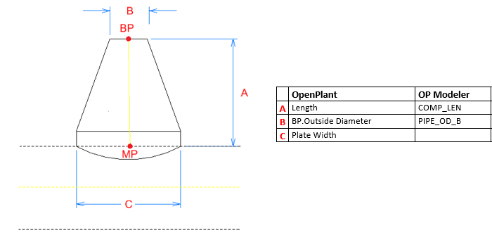

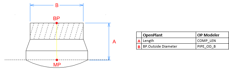

We were able to derive the Drawing Parameters along with the Preview of the components by tallying the values from the OPM component model with that of the Specifications.Similar procedure can be followed for other components that have missing preview and description.
For Pipe Wye:
For Lap Joint Flange:
For Weldolet:
For Threadolet:
For Sockolet:
For Elbolet:
For Latrolet:
For Saddle:
For Nipolet:
For Sweepolet:
For Y-Strainer:
