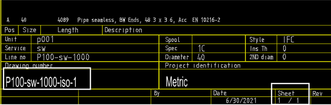

User requirement is to add the sheet number as per the (split sheet number / Total number of sheet). Currently, it is showing sheet numbers in the isometric drawing as shown below

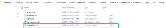

  1. Navigate window files
  2. Open the txtfile in notepad++. Use default path as mention below
    C:\ProgramData\Bentley\OpenPlant CONNECT Edition\Configuration\Workspaces\OpenPlantExample\WorkSets\Imperial\Standards\OpenPlant\Isometrics\styles\IFC\config

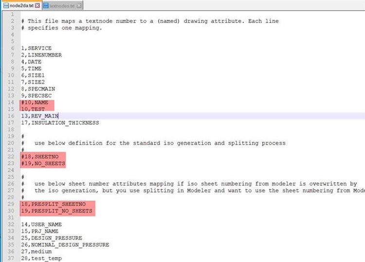

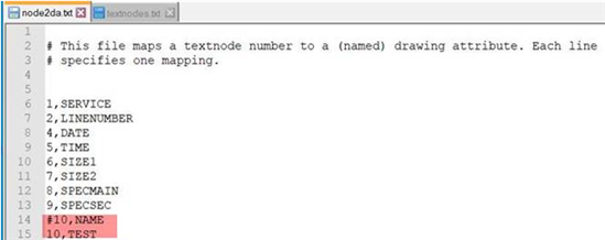

  3. . Uncomment the name property and add 10,TEST property the txt file as shown below
  4. Comment 18 & 19 for SHEETNONO_SHEETS using #. Un-comment this PRESPLIT_SHEETNO & PRESPLIT_NO_SHEETS as shown in below image.
    Change
            18,SHEETNO
            19,NO_SHEETS
             into:
            #18,SHEETNO
            #19,NO_SHEETS
             change
             #18,PRESPLIT_SHEETNO
             #19,PRESPLIT_NO_SHEETS
             into:
             18,PRESPLIT_SHEETNO

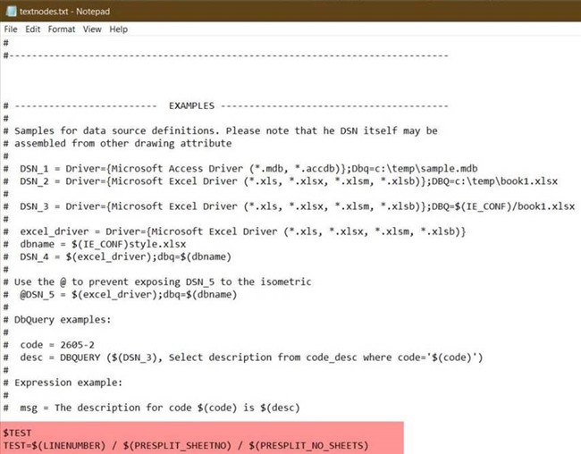

  1. Open text files in notepad++. Refer below image
  2. In textnodes.txt, add below changes
    $TEST
    TEST=$(LINENUMBER) / $ (PRESPLIT_SHEETNO)  /  $(PRESPLIT_NO_SHEETS)

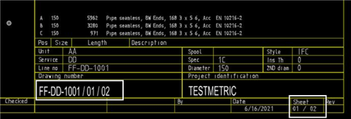

  3. Save all the changes. Launch Open modeler and regenerate the isometric.
  4. Verify the results in the isometric sheet.
