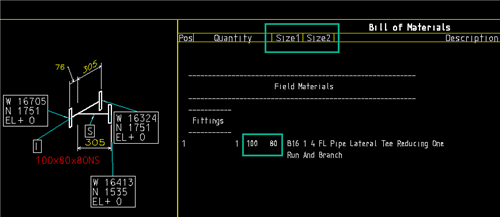

This article will explain, how to include 3 port size information in isometric sheet for a PIPE_LATERAL_TEE_REDUCING_ONE_RUN_AND_BRANCH. By default, size of tee show is in the format of size1 and size2 as shown in below

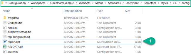

  1. Open the file explore. For the opening of report.def file, please use below mention path.
    C:\ProgramData\Bentley\OpenPlant CONNECT Edition\Configuration\Workspaces\OpenPlantExample\WorkSets\Metric\Standards\OpenPlant\Isometrics\styles\IFC\config

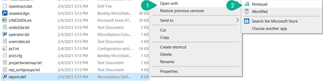

  2. Open the report.def file in the notepad as per your required workset as shown below.

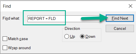

  3. Press Control+F and find REPORT = FLD, click on find next as shown below

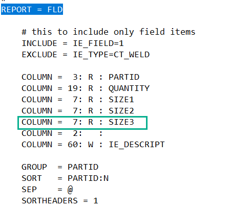

  4. In this report file, define COLUMN=7:R:SIZE3 as shown below
  5. Click on file and save all the changed setting as shown below.

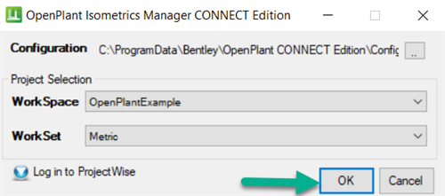

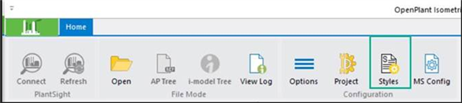

  6. Launch OpenPlant isometrics manager with using required workspace and workset and click on Refer below image
  7. Click on the style ribbon tool as shown below.

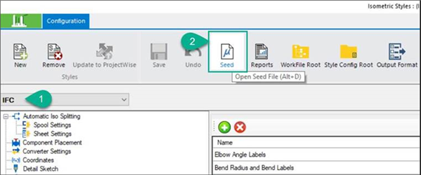

  8. From the style icon select the iso style as per your requirement and click on the seed file. Refer below image

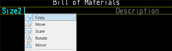

  9. Copy the SIZE2 and Paste as shown below.
  10. In the seed file (Template) add the size3 column as shown below
