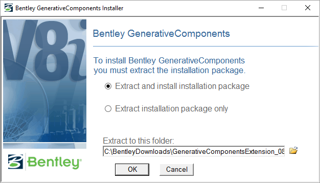

Once AECOsim Building Designer SS6 (08.11.09.829) is installed and having downloaded GenerativeComponents Extension 08.11.09.349 (note there is also a standalone version with the same version number, this is deliberate to denote that they are the same release, be sure you have the extension, it is a tiny download so the difference will be obvious!) run the installer:
Step one extracts the download to the C:\BentleyDownloads.
[Note that you can change this to another drive by altering the drive letter in this dialog, you may wish to do this to save space on a relatively small SSD primary drive where a large storage HD is also available, these files are only used during installation so there is no long term benefit in having them on a primary SSD.]

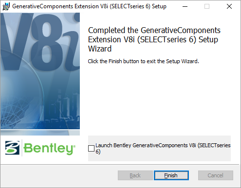

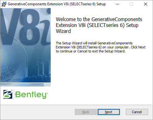

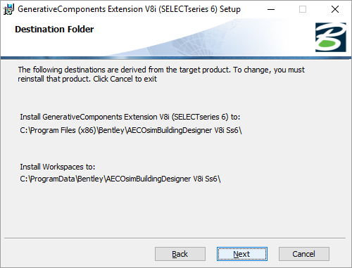

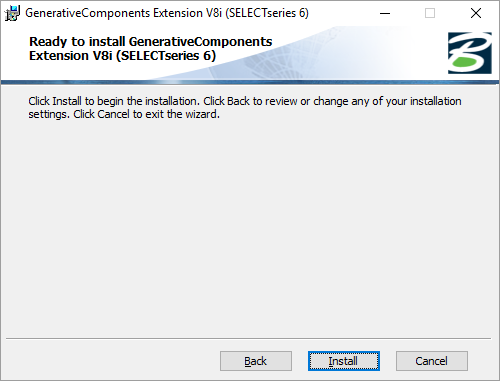

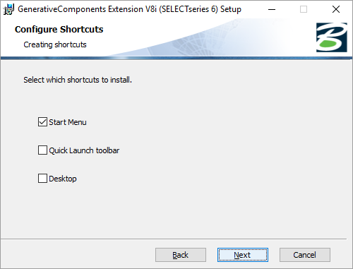

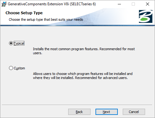

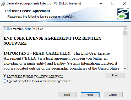

Click Ok and then run through the remaining dialogs:

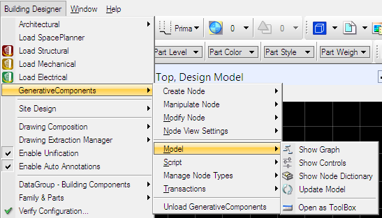

Once finished there will be an additional start menu shortcut 'GenerativeComponents for AECOsimBuildingDesigner V8i (SELECTseries 6)' and inside ABD either the option to load GenerativeComponents:
Or once loaded (or if started from the GenerativeComponents shortcut) the full set of GenerativeComponents menu items will be available:
