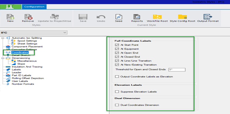

2. In Coordinates, follow the same set up.

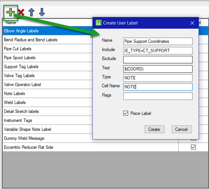

3. Create new User Label and apply the given values.
Name: Pipe Support Coordinates
Include: IE_TYPE=CT_SUPPORT
Text: $(COORD)
Type: NOTE
Cell Name: NOTE

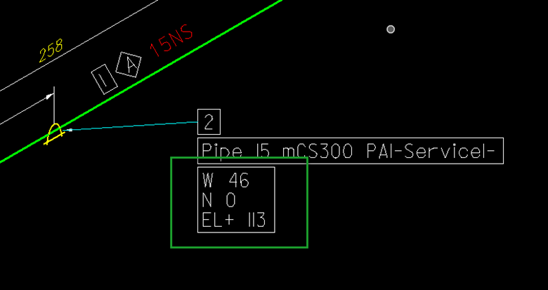

4. Generate Isometrics and verify the result.
