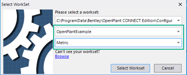

1.Launch OpenPlant Specification Generator CONNECT edition.
2. Select the desired WorkSpace and WorkSet.

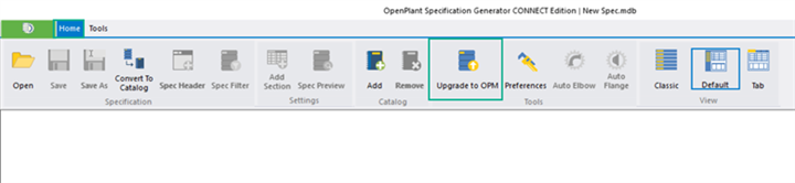

3. In the Home tab, select Upgrade to OPM.

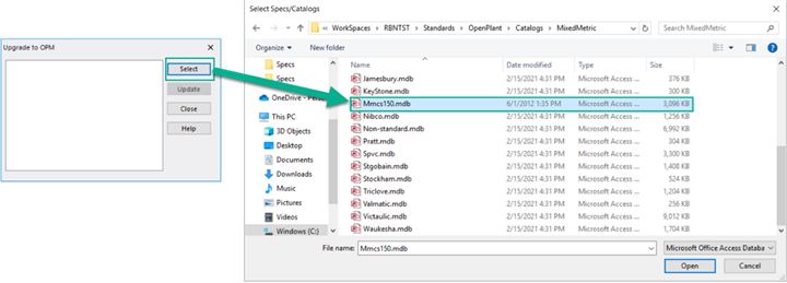

4. Click on Select and select the AutoPlant Catalog file and click on Open.

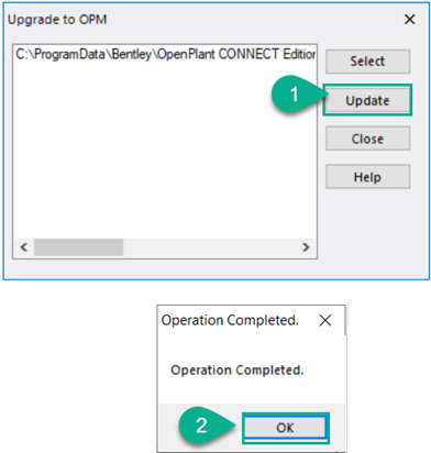

5.Click on Update and click Ok to proceed.

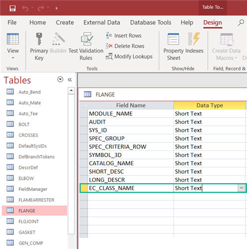

6.After upgrade there is a new field EC_CLASS_NAME added in the AutoPlant Catalog tables.
