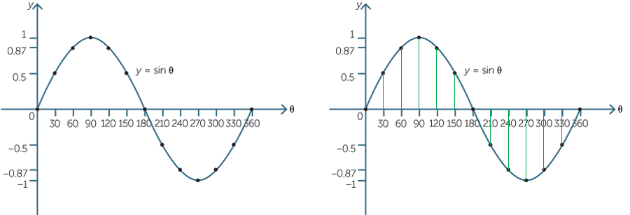

In the case of the Sine curve y = Sin(x) with x ϵ [0°, 360°]
...if it is sampled at independent variable x from 0° to 360° in steps of 30° yields
y = {0.0, 0.5, 0.866, 1.0, 0.866, 0.5, 0.0, -0.5, -0.866, -1.0, -0.866, -0.5, 0.0}
...as dependent variable.

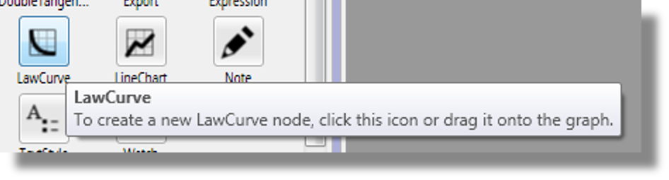

The new LawCurve is placed by dragging and dropping the LawCurve icon into the Graph window.

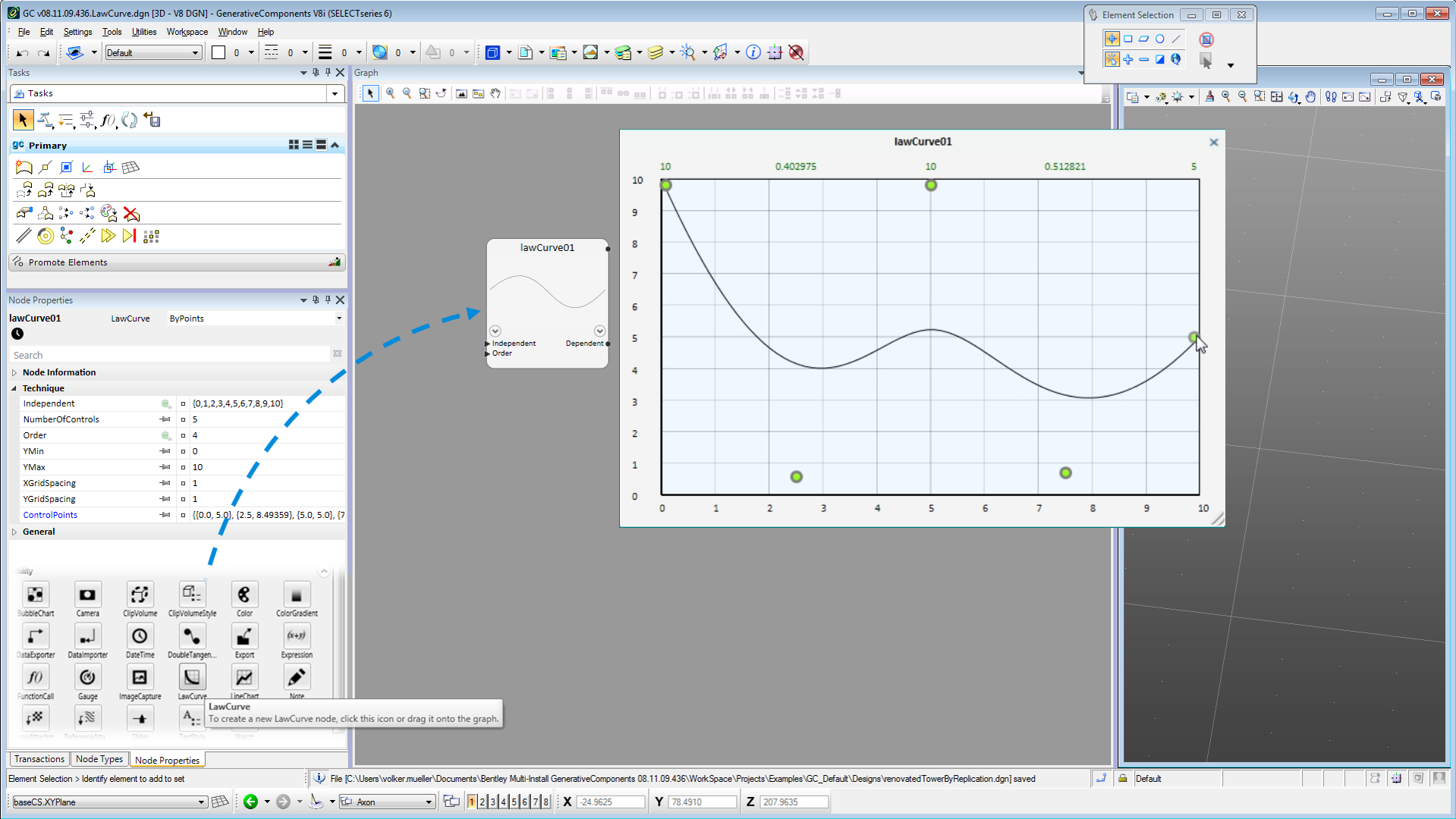

After clicking on the curve preview on the node the larger curve control opens in which the vertical position of the control points can be interactively controlled to modify the curve.
The introductory LawCurve video describes the advantages of the current LawCurve implementation and what a control could look like that emulates the previous implementation of the LawCurve.
