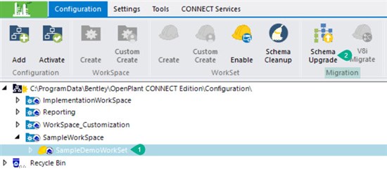

  3. From Configuration ribbon tab, click on root node of configuration. This will enable the option of V8i Migrate from Migration ribbon group. Refer image as shown below.
  4. Click on V8i Migrate option as shown in above image.

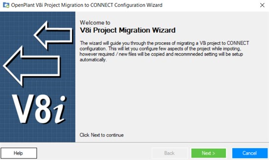

  5. From Migration wizard, click on Next as shown below.

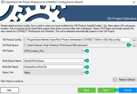

  6. From Migration wizard, click on three dots defined against V8i WorkSpace. This will ask to select the workspace of OpenPlant Modeler V8i. Please pick the workspace folder using file explorer.
    Note: WorkSpace folder must contain the proper folder structure as it is for OpenPlant Modeler V8i workspace. Refer image as shown below.
  7. From same dialog, select the desired V8i project from drop down.
  8. Enter desired name for workspace & workset. Also, pick the correct unit of V8i project. Refer sequential steps from below image.
  9. Once desired V8i project is selected, click on Next as shown in above image.

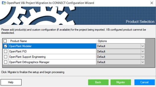

  10. From Migration wizard dialog, ensure to check the OpenPlant Modeler application as shown below.
    Please note that up to OpenPlant Modeler V8i we don’t have concept of common workspace for multiple application. Since we are doing migration considering the workspace from V8i generation, it is advisable to pick the specific application only. Here in this case we have picked OpenPlant Modeler only.
  11. Once OpenPlant Modeler application is checked, click on Migrate Refer above image for reference.

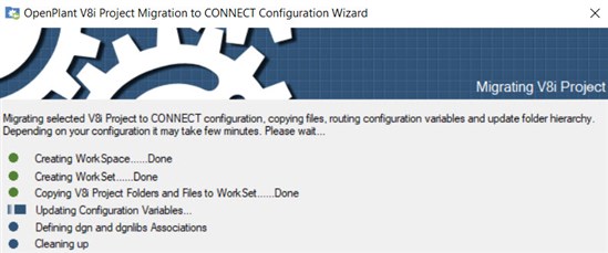

  12. Once Migrate process is executed, this will check all the required links & setup workspace (folder structure) required to be used with OpenPlant Modeler CONNECT Edition. Refer image as shown below.

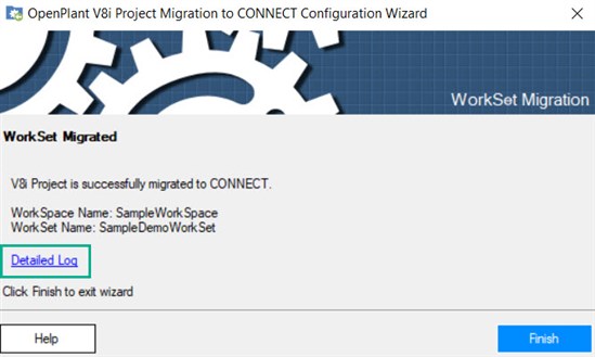

  13. When migration process is successfully executed, it will prompt successful message to dialog. Also, a detailed log tab is available. Click on the detailed log tab to see detailed information that has been pushed.
  14. Click on Finish, refer image as shown below.

  16. Select the workset & select Schema Upgrade option to upgrade schema.

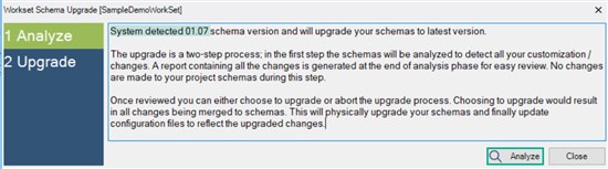

  17. Schema Upgrade process is a two-stage procedure. First stage is Analyze & second one is UpgradeDuring Analyze, it detects the V8i schema version. This version will be upgraded to OpenPlant Modeler CONNECT Edition.
  18. Click on Analyze. Refer image below.

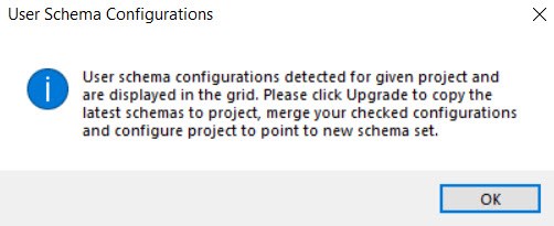

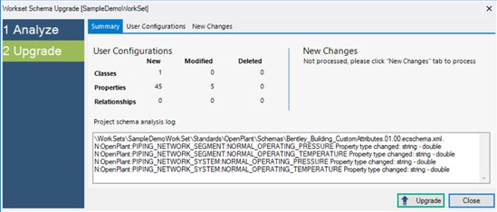

  19. Once Analyze is completed, it will prompt to show that user configurations have been detected. Click on OK.

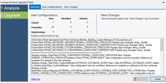

  20. After the successful Analyze, Upgrade option will be available. Click on Upgrade as shown below.

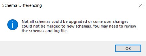

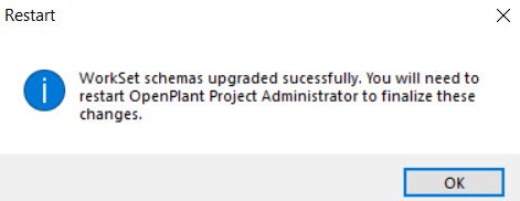

  21. Once schema upgrade is successfully executed, a prompt will show to review schema differencing. Click on OK.
  22. From WorkSet Schema Upgrade dialog, click on Close. Refer image as shown below.
  23. This will prompt Restart dialog to reflect the schema changes for the upgraded workset as shown below.
  24. Launch OpenPlant Modeler CONNECT Edition with the upgraded workspace to verify the migration & upgrade.
