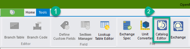

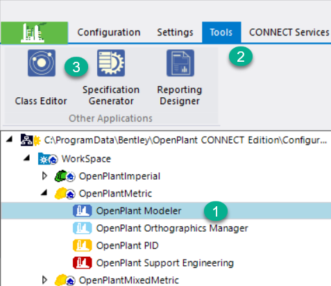

  2. Click on Desired workset and expand the node, select OpenPlant Modeler and then click on Tools Tab and launch specification generator.
  3. From OpenPlant Specification Generator window, navigate to tools tab and click on Catalog editor.

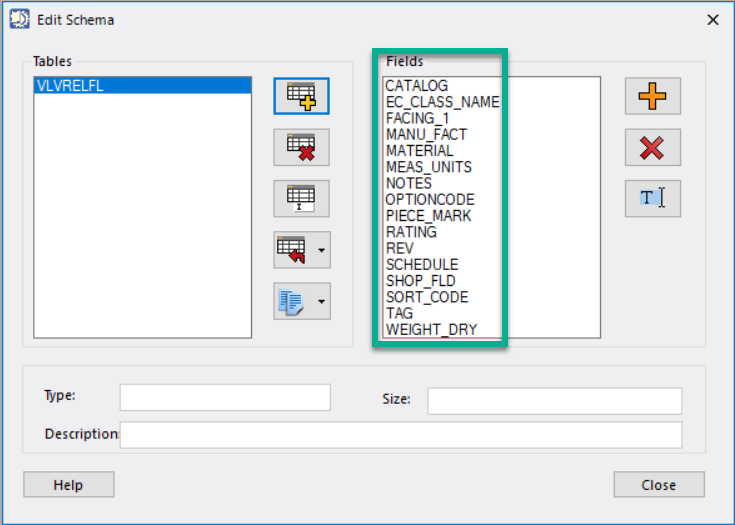

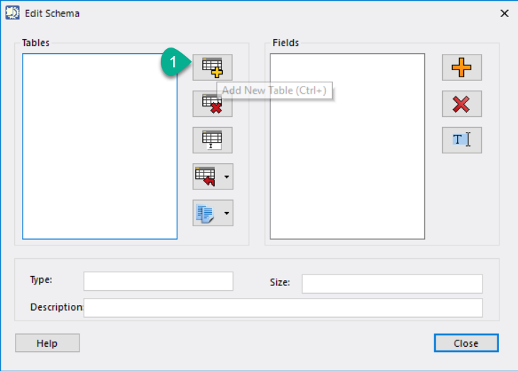

  5. In Edit Schema window, click on Add tables or press “Ctrl +”, lets say we want to add new table for Relief Valve for this exercise and hit Ok.
  6. After pressing OK, we will see Fields column are populated on the right-hand side.

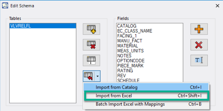

  7. Now click on Import Data option and select import from excel and select excel file from the desired location.

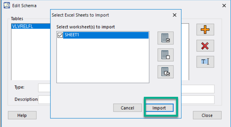

  8. A dialog will open asking which sheet(s) can be selected, select sheet and click on Import.

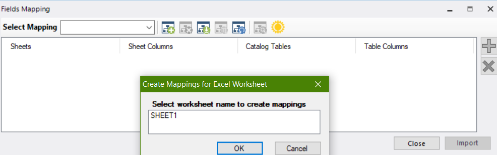

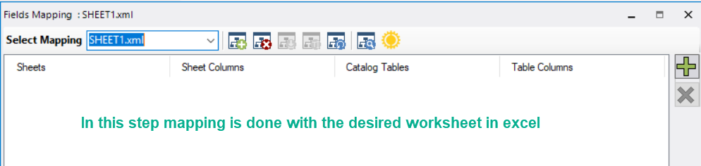

  9. Once the importing is done, a field mapping window will be opened. Click on green + button and select the sheet for mapping.
    NOTE : Fields Mapping dialog display when you are importing data into a catalog from a Excel spreadsheet. Before the data can be imported, the fields in the Excel worksheet must first be mapped to their corresponding column of the table in the catalog.

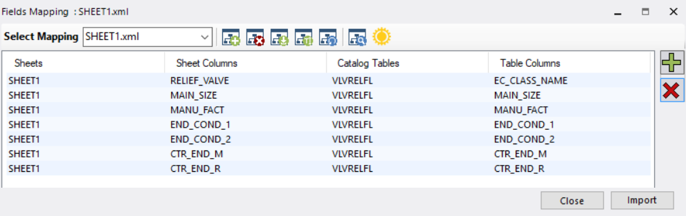

  10. Click on + icon on the Right-hand side, which will start adding, below fields are shown for illustration.

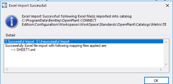

  11. Now click on Import Button and this will import data from excel and Export Successful message will pop up. Like shown below.

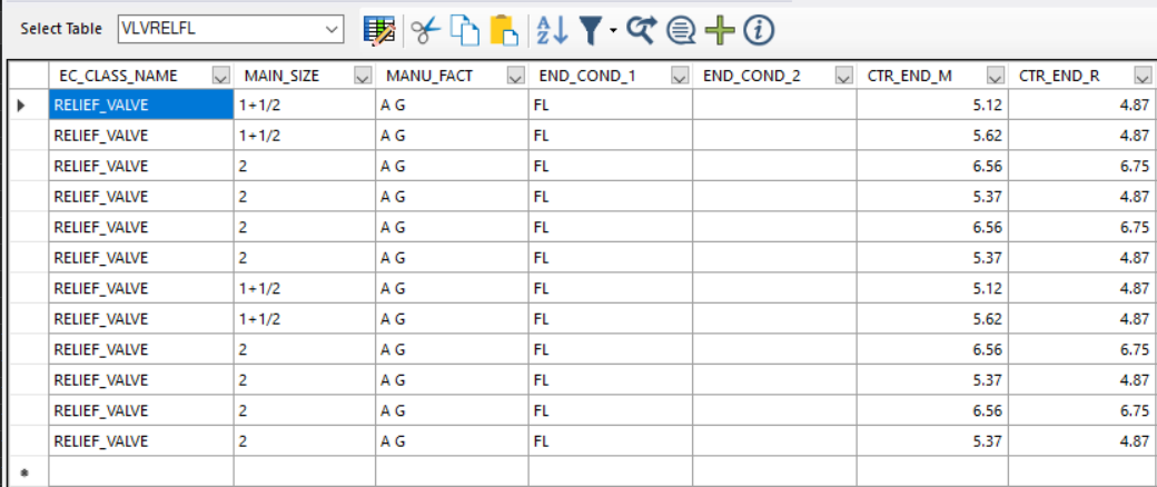

  12. Click on Close button and in Catalog Editor windows, in select  table select Relief valve and verify opening the newly create catalog by clicking on Open Button.
    NOTE : Before saving mdb file, we can use preview button as well to see how the catalog looks like after adding fields.
