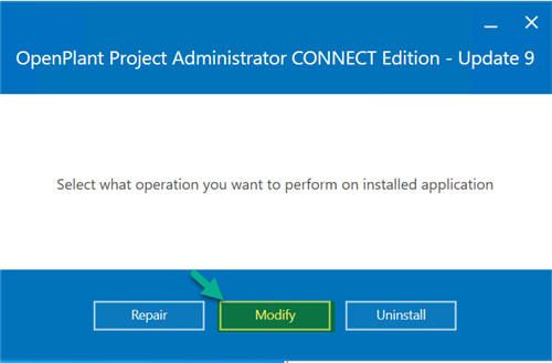

  2. After setup is initiated, OPPA installation window will be displayed which will ask for operation to be performed on application which is not installed. As shown in below from 3 options in bottom select Modify.

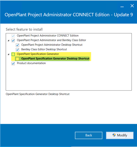

  3. Clicking on Modify all features which is currently & needs to be installed from OPPA CE gets reflected. It can be noticed that since feature OpenPlant Specification Generator was not installed hence it is not preselected by application and others are already selected

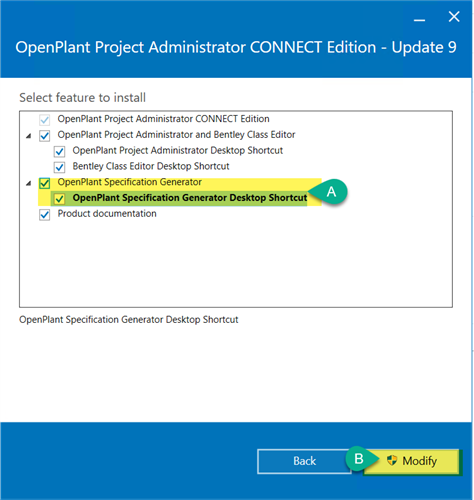

  4. Proceed to select both feature of OpenPlant Specification Generator and OpenPlant Specification Generator Desktop Icon Shortcut such that a tick would get reflected as shown in below and hit on Modify.

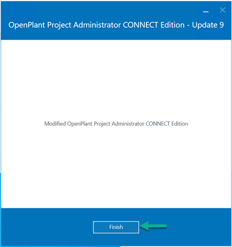

  5. After Modification is completed below notification is reflected in setup of OPPA, Hit on Finish.
  6. After clicking on Finish, Specification Generator gets installed and the Icon gets reflected in Start menus of Windows or on Desktop

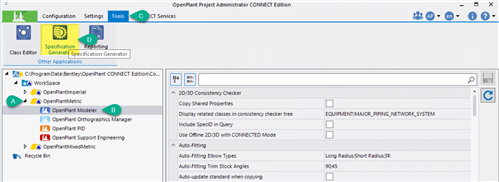

  7. Another way of Launching of Specification Generator is through selecting required workset as shown in below image. Click on OPPA icon→ Select the WorkSet→ Select the Application e.g OpenPlant PID or OpenPlant Modeler→ Tools→ Specification Generator would be reflected.

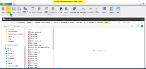

  8. Specification Generator window gets launched as shown below and further can be proceeded with required operation.
    In this both way Specification Generator gets launched Successfully using OPPA CE.
