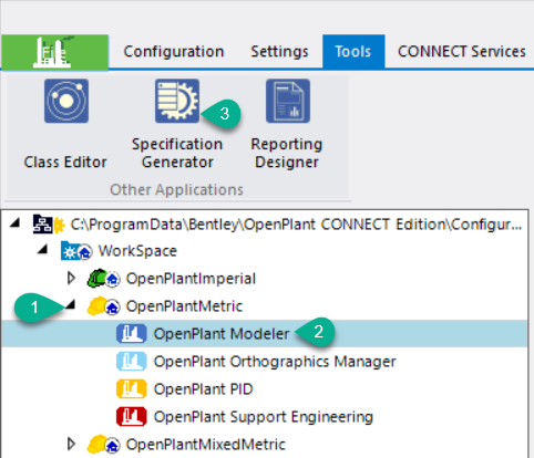

  1. Launch OpenPlant Project Administrator CONNECT Edition.
  2. Select the desired WorkSet, expand the node and click on OpenPlant Modeler and from tools Tab launch Specification Generator.

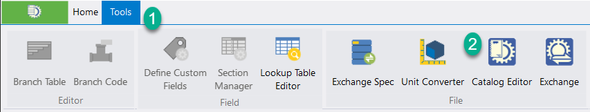

  3. Once Specification Generator is launched, from the Home Tab, click on Tools tab and select Catalog Editor.

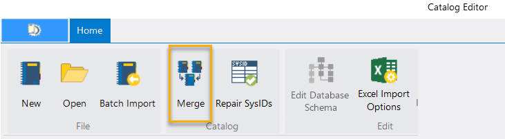

  4. From Catalog Editor option, select Merge option.

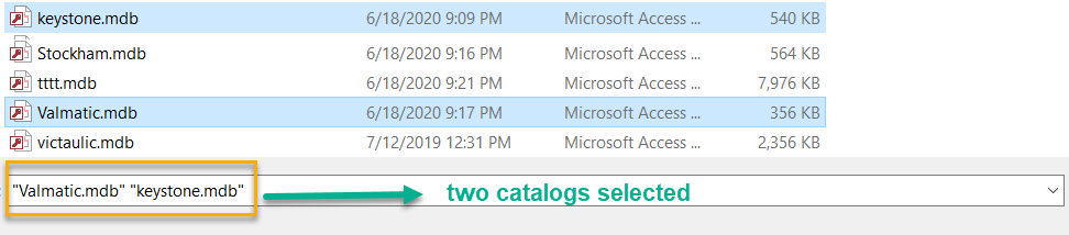

  5. Select the catalogs to merge from the list. To select multiple catalogs, hold down the <Crtl > button while making your selections and Click Open. The catalogs will be listed in the File Name field. Here , Keystone and Valmatic.

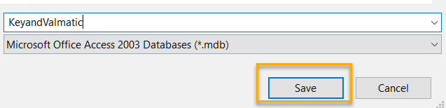

  6. Click Open and select an output location for the merged catalog , give a desired name for Merged Catalog , here KeyandValmatic and hit save option.

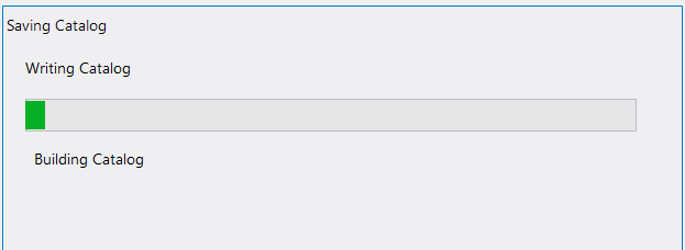

  7. Upon clicking Save, you will see below dialog.
