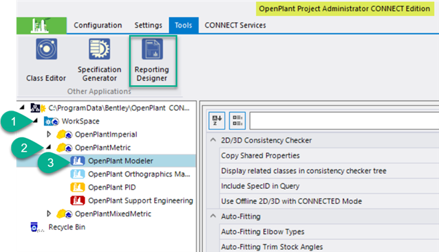

2. In OpenPlant Project Administrator, open Reporting Designer for desired WorkSet as shown below.
3. This opens-up Reporting Designer tool.

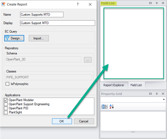

6. Edit “Name” & “Display”, select Product-line for which this Report can be generated then click on “Design”.

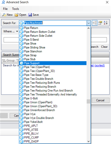

7. Select “Pipe Support” in drop down.
8. Once done, click OK and check the “Field List” getting updated thereafter.

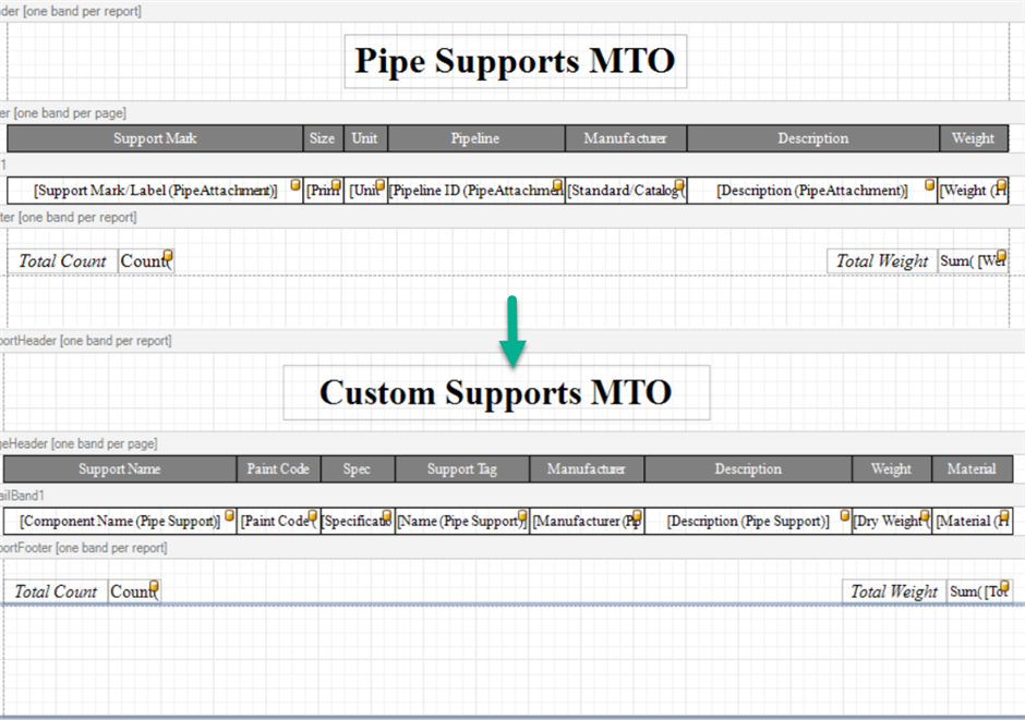

9. Below is the look of Report before editing it further as per requirement by utilizing “Field List”.

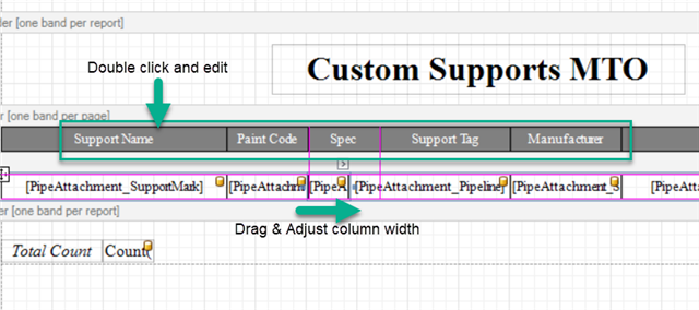

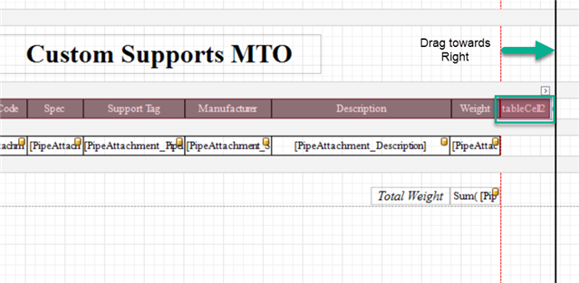

10. Edit Previous column names by double clicking on it & renaming it directly. Also, with simple drag & adjust vary column width to set it proportional.

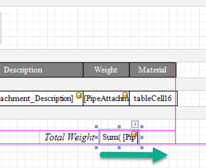

11. Add an extra column as shown below.
12. Adjust the Side Margins by dragging towards right hence fitting-in the New Column.
13. For other sections of Table, a similar drag & adjust action can be applied for proportioning the Report Table.

15. Final Reporting Template looks as shown below after editing.
16. In OpenPlant Modeler CE, Run the new “Custom Support MTO” as shown below.
17. Below is the Report as per requirement for created Assembly.
