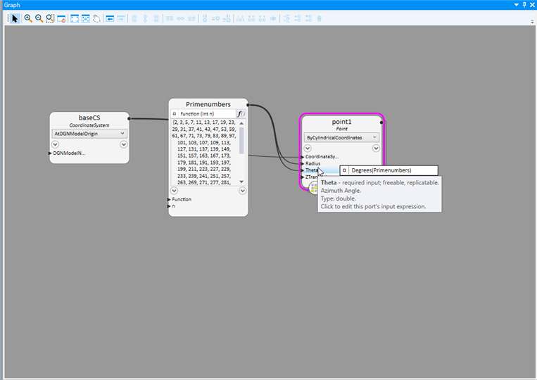

         We will create a list containing all the prime numbers in first n numbers. For this, we will use the "Function" node and create a         custom function. The script is as follows.
	function (int n)
	    int prime= {2,3};               //corner case
	    for (int j = 5; j < n; ++j)     //check for number from 5 to n-1
	        int a=1;
	        for (int i = 2; i < j/2; ++i)
	            if(j%i==0)
	                a=0;
	                break;
	         if(a==1)
	             prime.Add(j);      //adding number to list "prime"
	    return prime;
        Here, naive algorithm is used for generating the prime numbers with little modification.
Step 2
After having the list of prime numbers, we will be using it as input for a Point node with technique ByCylindricalCordinates. The prime number list will be used as input for both the Radius and the Theta. However, for the input Theta prime number list should be converted to its corresponding degrees. For this, we use the function Degrees().
