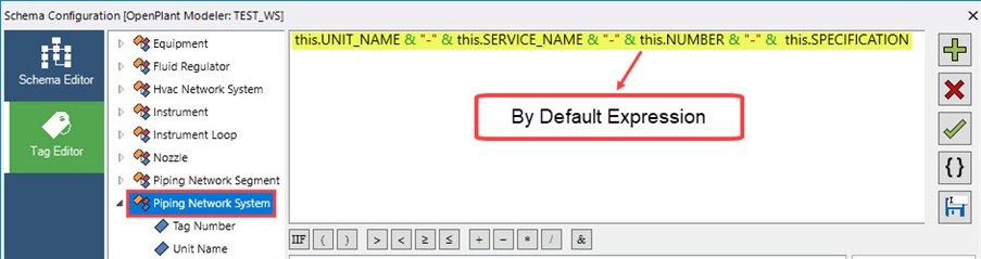

  2. From Settings ribbon, expand desired workset, here OpenPlant Imperial workset is considered & select OpenPlant Modeler application. Click on Settings > Tag Editor as shown below.
  3. From Left pane select Piping Network System to modify Tags for Pipeline. This will show the Default Expression that system is taking after placing the Pipeline as shown below.
    Expression :- this.UNIT_NAME & "-" & this.SERVICE_NAME & "-" & this.NUMBER & "-" & this.SPECIFICATION
    Pipeline Tag with above Expression is shown below

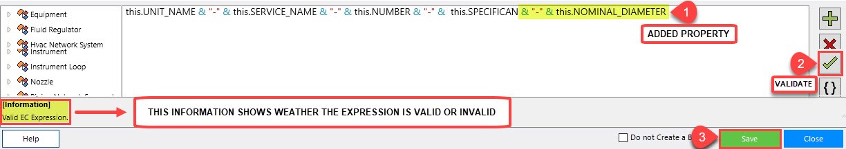

  4. In the previous Expression add the desired property (here NOMINAL_DIAMETER as an example) that to be evoked in Tag. Then Validate the current expression & Save as shown
    Expression :- this.UNIT_NAME & "-" & this.SERVICE_NAME & "-" & this.NUMBER & "-" & this.SPECIFICATION & "-" & this.NOMINAL_DIAMETER

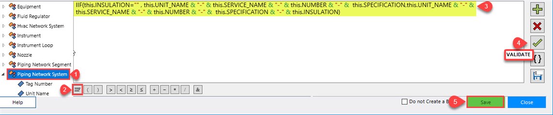

  5. Now, for example the requirement is to evoke property of Insulation Material on Tag of Pipeline by IIF Expression as shown. This IIF Expression works as, for example some Pipeline has insulation & some will not. This expression let the system read when the Pipeline is insulated it should reflect the material name on Tag & if Pipeline is not insulated then it should be blank. Once done, Validate the expression & Save it.
    Expression :- IIF(this.INSULATION="" ,this.UNIT_NAME & "-" & this.SERVICE_NAME & "-" & this.NUMBER & "-" & this.SPECIFICATION,this.UNIT_NAME & "-" & this.SERVICE_NAME & "-" & this.NUMBER & "-" & this.SPECIFICATION & "-" & this.INSULATION)

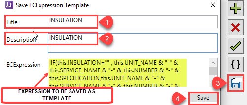

  6. One can save the Expression as template. Select Save Expression as template option at right pane. Fill the required Fields & hit Save as shown.

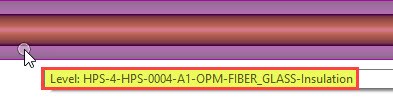

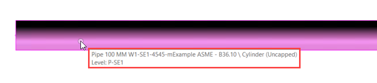

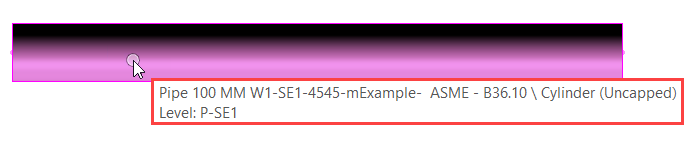

  7. Launch OpenPlant Modeler CONNECT Edition, place a Pipeline without insulation & notice the behavior as shown
  8. Now, place a Pipeline with Insulation Material Fiber Glass & notice the behavior as shown

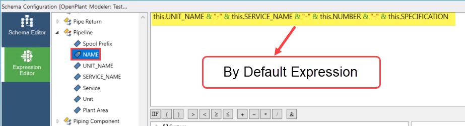

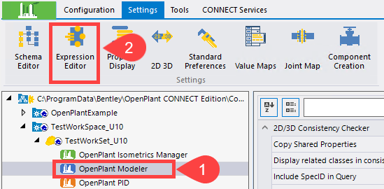

  9. From Settings ribbon, expand desired workset, here OpenPlant metric workset is considered & select OpenPlant Modeler application. Click on Settings > Expression Editor as shown below.
  10. From Left pane select Pipeline. It is showing the Name property in Expression.
  11. Select Name Property to modify Tags for Pipeline. This will show the Default Expression that system is taking after placing the Pipeline as shown below.

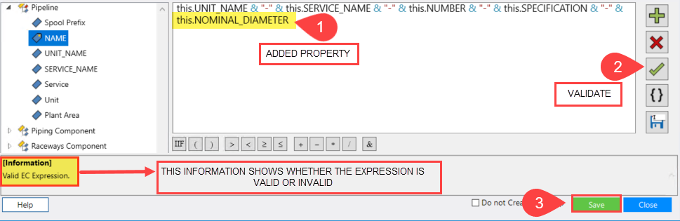

  12. In the previous Expression add the desired property (here NOMINAL_DIAMETER as an example) that to be evoked in Tag. Then Validate the current expression & Save as shown
    Modified Pipeline Tag with above Expression is shown below
    As shown, Nominal Diameter is available in the Tag.

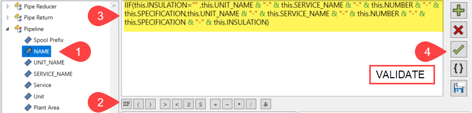

  13. Now, for example the requirement is to evoke property of Insulation Material on Tag of Pipeline by IIF Expression as shown. This IIF Expression works as, for example some Pipeline has insulation & some will not. This expression let the system read when the Pipeline is insulated it should reflect the material name on Tag & if Pipeline is not insulated then it should be blank. Once done, Validate the expression & Save it.

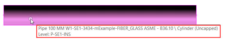

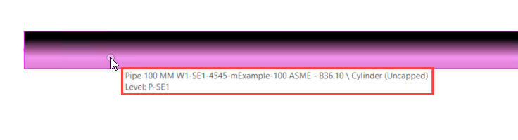

  14. Launch OpenPlant Modeler CONNECT Edition, place a Pipeline without insulation & verify the result as shown
  15. Now, place a Pipeline with Insulation Material Fiber Glass & verify the result as shown
