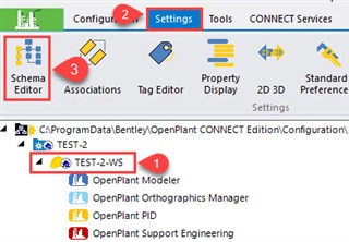

  1. Launch OpenPlant Project Administrator CONNECT Edition.
  2. Select the desired workset & launch Schema Editor from Settings as shown

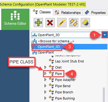

  3. Select any desired Class as shown

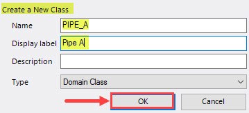

  4. Go to pipe > Right Click > Add Derived Class as shown
  5. Add Derived class in parent Class Pipe. Derived class is the class that inheritates all the properties of Parent Class.
    (Here PIPE_A is the new Derived Class as shown)

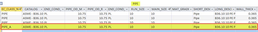

  7. From the location mentioned below, open the required spec in which Class should be added.
    C:\ProgramData\Bentley\OpenPlant CONNECT Edition\Configuration\Workspaces\TEST-2\WorkSets\TEST-2-WS\Standards\OpenPlant\Specs
  8. Add record to the Spec for Newly Added Derived Class as shown
    (Here, the Spec is EX-OPM)
    Save the Spec once added.

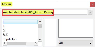

  11. Once done, Hit Enter on the Working Interface to launch Key-in Dialogue.
  12. Insert the Key-in & hit Enter as shown below

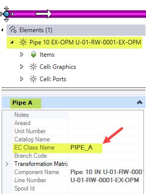

  13. Place pipe with the above records & check the properties as shown
    Thus, Derived class PIPE_A is successfully placed in OpenPlant Modeler Via OpenPlant Project Administrator.
