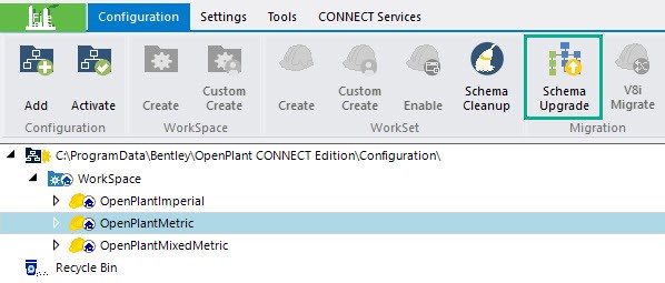

  1. Launch OpenPlant Project Administrator CONNECT Edition.

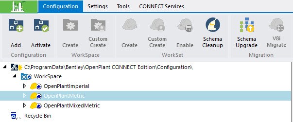

  2. From Configuration ribbon, select desired workset that needs to be upgraded. In this case OpenPlantMetric is considered, refer image below.
  3. From Migration ribbon, select Schema Upgrade tool as shown below.

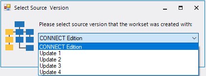

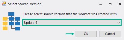

  4. From Select Source Version window, click on drop down arrow & select Update 4, refer image below.
  5. Once selected, it should reflect like as shown below.
  6. Select OK

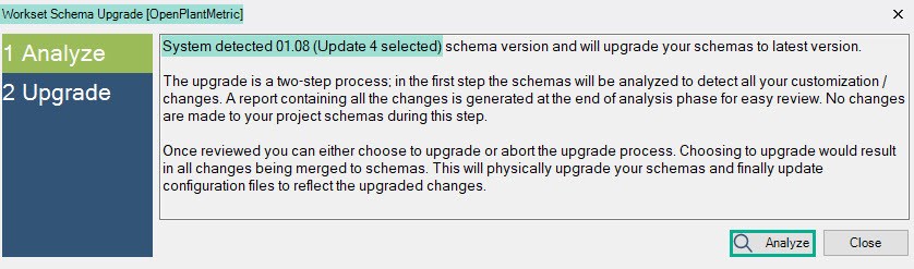

  7. To Workset Schema Upgrade dialog, select Analyze option to analyze the schema version. Refer image below.

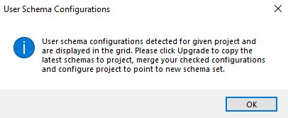

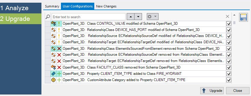

  8. This will Analyze the schemas of selected workset & pop up window to show User Schema Configurations, refer image below.

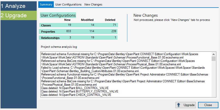

  9. Click on OK to proceed. This will show the summary regarding user’s configurations schema changes as shown below.
    Please note that number of user configuration changes will be different based on extent of customization available to workset.
  10. Click on User Configurations tab, notice the defined color coding. Refer image below.
     Shows that new class/property/Relationship has been added
     Shows that new class/property/Relationship has been modified
     Shows that new class/property/Relationship has been deleted
  11. Click on Upgrade to perform schema upgrade task.

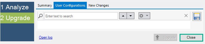

  13. Once Analyzing & merging process is successfully carried out, it will pop successfully upgraded message as shown below.
  14. Click on Close to finish the schema upgrade task.

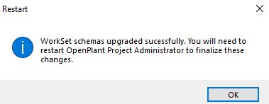

  15. Closing the dialog will pop to perform Restart Click on OK. Refer image below.
  16. Launch OpenPlant Modeler CONNECT Edition with upgraded workset & check its working/functionality.
