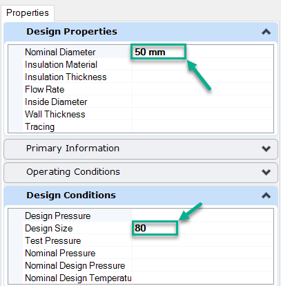

In OpenPlant PID CE, placing pipeline with a defined Design Size values doesn’t cascade its value to the Nominal Diameter property.

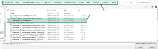

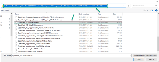

  1. Launch Bentley Class Editor V8i

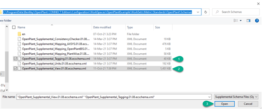

  2. Open “OpenPlant.01.08.ecschema.xml. ec schema from workset location”

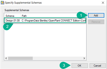

  3. Supplement “OpenPlant.01.08.ecschema.xml with “OpenPlant_Supplemental_Tagging.01.08.ecschema.xml & OpenPlant_Supplemental_View.01.08.ecschema.xml

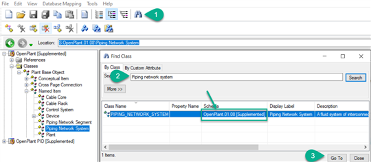

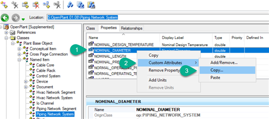

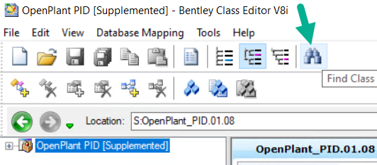

    a. From Find class tool search for PIPING_NETWORK_SYSTEM, refer image as shown below
    b. Switch to Properties Tab > search for NOMINAL_DIAMETER > Right click > Custom Attributes > copy (Category)

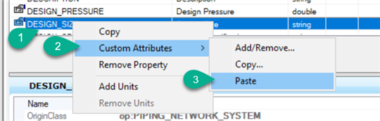

    c. Search for DESIGN_SIZE > Right click > Custom Attributes > paste (Category)
  4. Open “OpenPlant_PID.01.08. ec schema from workset location”
  5. Supplement “OpenPlant_PID.01.08.ecschema” with OpenPlant_PID_Supplemental_Design.01.08.ecschema

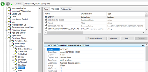

  6.  From Find class tool search for PIPELINE, refer image as shown below

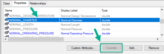

  7. Go to Pipeline class and switch to Properties tab.
  8. From Properties tab search for NOMINAL_DIAMETER and click on Override to localize the property.

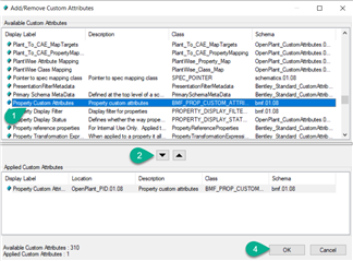

  9. For NOMINAL_DIAMTER property, add Property Custom Attributes from Add/Remove list and fill the details as shown.
    Refer image as shown below.
    a. Property Custom Attributes

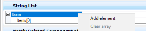

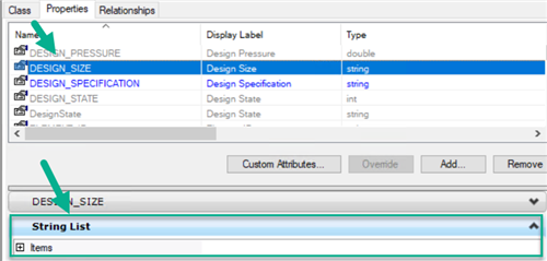

  10. From Properties tab search for DESIGN_SIZE and add String List Custom Attributes as shown below.
    a. Right click on Items and select Add element as shown below.
    b. Enter details as NOMINAL_DIAMETER

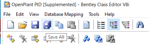

  11. Save All schema changes.
  12. Launch OpenPlant PID CE U9 and verify the result.
