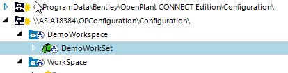

  3. Browse to the Custom Project.

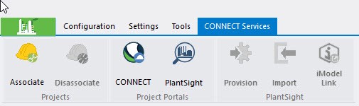

  4. Select the Bentley CONNECT Services Ribbon.
  5. Select Associate.

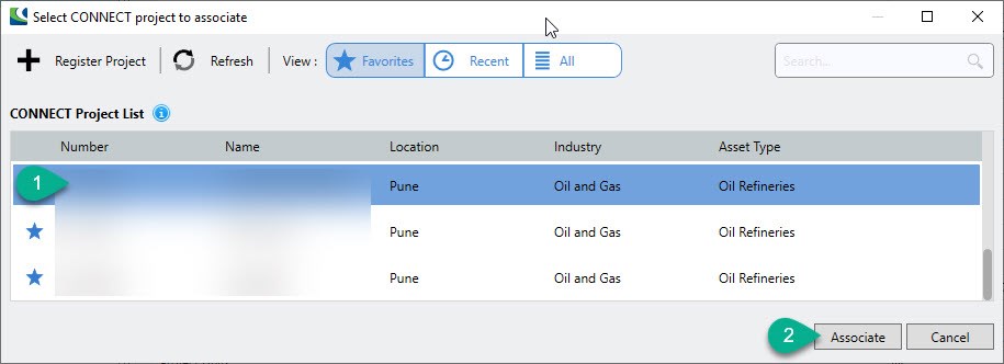

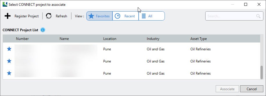

  6. The CONNECT Project Selection dialog will open.
  7. Select a project and click Associate.
  8. The WorkSet cap will turn green in color indicating successful association.
